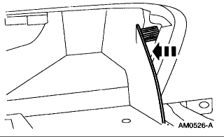

It's not in a door but behind the dash. The blend door vacuum motor is behind the glove box. There are 2 other vacuum motors located behind the center console near the floor. You can see the panel/floor motor from the driver's side looking up under the dash towards the center console. I'm not certain where the panel/defrost is located visually as my diagrams don't show it and I can't visually see it but I suspect it's behind the center console on the passenger side so you may need to remove the radio to see it.
Air blend door vacuum motor behind glove box, can be seen from passenger floor looking up into dash
You can see the panel/floor vacuum motor from the driver's floor looking up into the center console area.
Panel/Defrost - not certain on location
