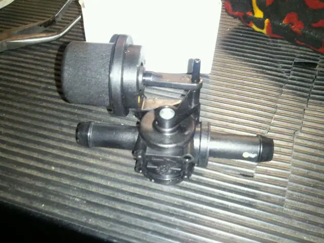

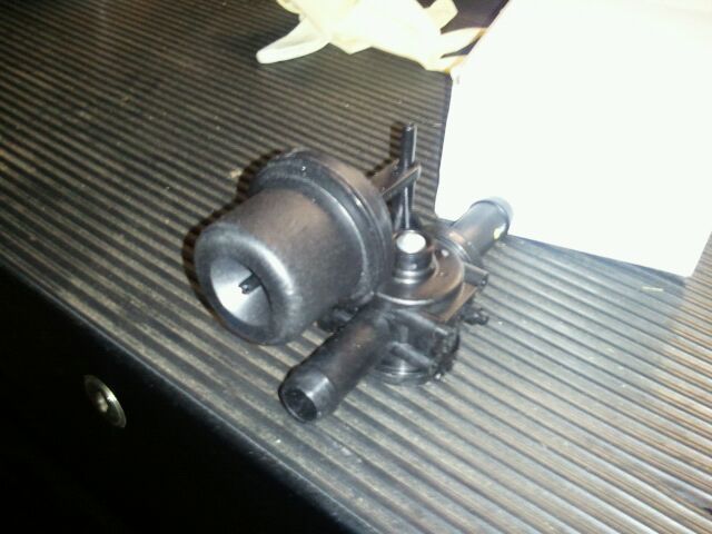

Sorry for such a late response on this, so much to do such little time......story of my life :)
Below is pictures of the actual part I purchased notice the bar that mounts to the engine is not there, I didnt reuse the exsisting mount being it didnt fit the new HCV

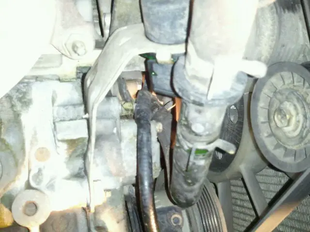

Location in Engine Compartment
Here is the location in the engine compartment, sorry for the bad photo there isnt much room to get in there. This is on the passenger side right near the passenger side wheel well.

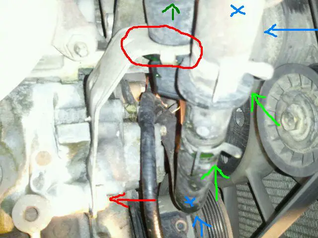

Now for the fun part :hammer:
Tools needed:
2 vice grips - small
9/16 wrench...If my memory serves me right :rolleyes:
Pair of needle nose pliers, or your choice of pliers
Patience :shifty_ey
I went through the passenger side fender well for access to the HCV, some may have to remove the spash gaurd to gain access.
Now after dumping most my antifreeze on the ground I realized I should have clamped off both hoses before starting this project :banghead:
There is a small vacuum line connected to the top of the HCV...disconnect and move line aside out of harms way.
Now remove your two hose clamps, I left mine on the hoses so they would be easy access once the new HVC was in. Now remove both hoses and expect a little spash of anti freeze :bsnicker: or in my case most of your anti freeze
Next I took the mount off that connects to the engine, there is only one bolt make sure your on the right one. Once removed you can see this mount is connected to HCV right near where the vacuum line connects, I removed this to put back on the engine but later found out it wouldn't fit the replacemnet so I left it out. There is a ring af about 6 prongs that need to be pried up in order to remove the mount. They are not very forgiving, I'd say make sure the size of the New HCV and old match up before ever bothering removing.
Now is reverse of everything stated above, The new HCV will have direction of flow marked on it with a small arrow, remember how you took the old one out and you should be fine, if you make the same mistake I did be sure to top off your coolent, once everything is hooked back up and toped off make sure to check for any leaks and make sure you reconnected the small vacuum hose.
Please see the photo for reference:
Bright Green - Hose Clamps
Dark Green - Top of HVC where vacume line connects
Red - Mount to engine and HCV
Blue - hoses to and from HCV
Blue X's - Kremp hose with vise grips
Poorly situated heater control valve
:)Hi joker1457,
You were very clear and helpful. MY HCV is also down below the alternator. You said, "My plan of attack is either go through the passenger side fender well". Does this mean you had to remove the fender? I'll try to just remove the air intake plenum.
Clamping the hoses first will save me a lot of trouble. Thanks much.
I removed the air intake and the upper radiator hose from the engine end and raised them out of the way. Then I replaced the heated control valve with a 5/8th to 5/8th inch tube splice($2.95). The valve still works, but its lower tube was broken causing the leak that cost me 8 gallons of anti-freeze during the last year.
