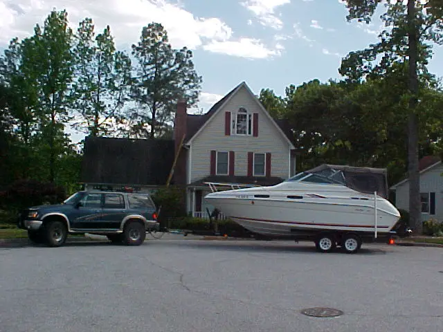

First off, I know the safety police will arrest me, but I'm still considering hauling a very big boat with my Explorer. Maybe.
I've already logged a lot of experience hauling this for several summers a few years ago:
That boat weighed 4,300lbs dry. I estimate that loaded with fuel/fluids and the trailer added, it had to weigh at least 3 tons. IIRC my '99 Explorer 4x4 with tow package was rated at 5,680lbs (?) so I was a little over the rating.
We are shopping for a bigger cruiser for this summer and really want to go up to a 25 footer (classic two-footitis, for you fellow boaters that know what that is LOL). The dry weight of the model we are looking at is 5,100lbs. That means I'm probably looking at a 7,000lb+ haul. Towing would be short range; our favorite lake is a 40 mile drive.
The boat I towed before felt at the very top of what my Explorer could handle. I stayed out of overdrive, drove very conservatively with long following distances from vehicles in front of me, never exceeded 60 mph, etc; and always made sure the boat was nearly empty of fluids (a full gas tank would add another 400lbs weight).... and seemed to do "okay".
To go bigger I know that brakes/cooling/transmission/etc will have to be upgraded - but at some point it won't matter; if I actually got in an emergency traffic situation, I am fully aware that the load will totally take over the much smaller Explorer. However a 3/4 ton or one ton pickup can haul HUGE loads much bigger than the truck, so the physics are similar and people do that all the time.
My question: does anyone have any experience towing a 7,000lb+ load with their Explorer? Has anyone even tried it?
PS: comments on my sanity are also welcomed, but please keep it civil :) I will probably forego doing this after more thought, but do wonder if anyone has tried it before.

Sorry I don’t have a pic yet, but a photo would look similar to the one in post #1; the "new" boat is one foot longer but the trailer is 3ft shorter.
