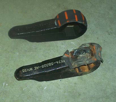

It might be the kevlar pad is non existant on your torsion keys.
Here is the new and old comparison
