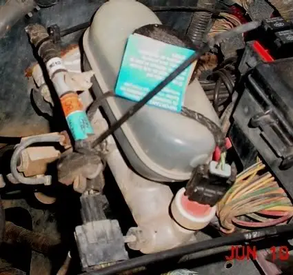

I believe a 2000 is included in the cruise switch recall. I'll look. Has it been done? Have a big blue tag on a wiring harness to the switch on the master cylinder?
Edit: The 2000 model year Explorer IS listed in the recall list for the SAFETY RECALL 05S28 cruise control FIRE recall. If you have not had the recall done, unplug the wiring from the switch on the brake master cylinder IMMEDIATELY and leave it disconnected until you have the recall performed. If the recall has not been done and it is now malfunctioning then you are at GREAT risk of you truck and anything near it catching fire and burning to the ground!
This is what the recall harness looks like, either exactly or similarly.

thanx ncranchero the recall has been done . but i don't know where to start checking or troubleshooting. is there a vacuum source or maybe a sensor?:(
