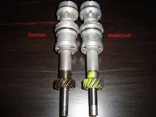

I just did mine in my limited 95 about 6 months ago or so. It was chirping as if I had a nest of baby chicks living on my engine block.
It's true, ours is unique to 94-95 Explorers ( as well as some 95 Aerostar & Ranger) yrs. 4.0 Liter (5.0 wasn't available in these yrs)
It's a pain to change since it's located dead center in the back of the engine near the firewall down about 8" inches or so. The easiest way to replace it is take your hood completely off your vehicle which I did. There's also no special tool needed to align ours, instead there's a glass see through window which you have to use to align it. Depending how bad your electrical connection is you may need to rewire it.
As far as which one you need. I'm 100% sure without any doubt that you'll need to purchase a re-manufactured one from A1-Cardone # 30S2605 (or 30-S2605) since they seem to be the only company that re-manufactures them.
If you purchase it locally at an auto parts store they are sometimes repackaged under different part #'s. Just have the counter guy cross reference #30S2605 (or 30-S2605) and you should be fine depending on how competent the parts counter guy is.
Cross Reference #'s :
Motorcraft OE Part # F3TZ 12K073-A = Cardone # 30S2605 (or # 30-S2605)
Mazda Part # ZZM32035Y = Cardone # 30S2605 (or # 30-S2605)
Bosch Part # 0232101012 = Cardone # 30S2605 (or # 30-S2605)
