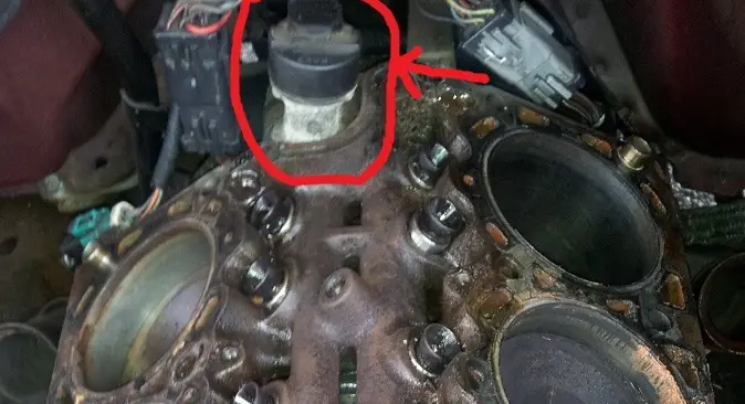

The culprit - a Mexican
The little magent was loose inside. Sometimes it would drag on the shaft below causing the chirp, dragging harder was a real squeal. The $25 Chinese replacement has the magnet enclosed within the plastic casting.
It is very tough to get at. The intake manifold hangs over it. I was able to replace without removing the manifold. Any shorter or fatter fingers and it wouldn't have been doable. Two wire bundles are significantly in the way. The two screws are 7/32". They turned easily. If hard turning- good luck. There isn't room for the socket after they come up just slightly. I was just barely able to see with a mirror, but not while working.

Just did mine yesterday. After all the threads on the synchronizer and how to's( Tdc, line the flag up, and any other concern, I was a. tad nervous about it. All I can say for anyone else wondering, what an easy job don't sweat it. It all makes sense when you get going and look at it. Btw, its nice not hearing that chirping/ squeal.
The problem I had with my explorer chirping was that my harmonic balancer had deterorated and was wobbling and chirping. Took me a long time to figure out until I had got a code (can't remember the exact code number) basically stating my crank position sensor had failed. When I got to replacing it I noticed marks on the balancer that matched the sensor magnets. After replacing both 2 months ago, no chirps and no engine codes. Runs smoother than ever. Just thought I'd throw that in.

Can anyone give me any insight into whether the chirping is caused by the sensor contacts rubbing or if its the actual bearings within the Synchronizer shaft?
I can get the sensor off of the unit currently installed in my truck but can't for the life of me get at the little bolt holding the retaining clip down to replace the entire unit.
If it's just the sensor unit I'll replace it with the reman one I purchased and button her back up. It would just really suck to put the manifold back on and tighten down only to find it was the bearings in the shaft all along.
Has anyone ever taken one of these apart to see what kind of bearing the shaft rides on?

The Synchronizer is a 3 piece unit. 1. The sensor Cap. 2 the Body 3 the shaft.
The body and the shaft are not separetly serviceable as far as i know. The shaft spins inside the body. A lack of lubricant combined with moisture combined with other engine gunk gets up in there causing the noise. Someone did post on here that they were able to get a shot oil down the shaft with the unit still in place. That may be a short term solution but eventually you will have to replae the unit. Watch out for cheap chines parts. The sensor cap has a much smaller sensor magnet which i found caused my OHV to run a little heavier on fuel. I put the original ford sensor cap back onto my new part and found more power and better fuel economy.

I was the guy who just took off the sensor cap, plugged the sensor screw holes and flooded the housing with oil and let it sit overnight (Posted 8/14/2011 Post #159). So far to this day there is no chirping on cold startup or anytime else. Motor runs super smooth and quiet. If you got the "chirps" why not give it a try....what've you got to lose? It's not that hard to do and I may make it a yearly maintenance item for me to take care of just to make sure it stays lubed.
I just replaced the synchronizer in my 98 Mounty 5.0. My replacement unit from Autozone did not come with an alignment tool so before removing the old unit, I made careful note of the position of the rotating vane. As a matter of fact, I actually turned the crank slightly so that the edge of the vane was in perfect alignment with one of the slots in the top of the old unit. I snapped a few pictures with my camera just to be safe.
I must say I had a horribly tough time removing the old synchronizer. After removing the pinch bolt, I actually had to tap a pry bar along the base of it to get it to come loose. It took quite a bit of tapping (as well as asking forgiveness for a few choice words that got muttered) before it came loose.
Installing the new unit was also an exercise in patience. When lowering the new unit into the hole, I had to use a block of wood and hammer to bump the part into place. I also discovered that the vane would rotate about 20 degrees or so before coming to rest. So, after about 6 times of trial and error, I finally got it installed flush with the vane aligned with the noted reference mark.
After everything was put back together, I held my breath and turned the key. It immediately fired up and has been running very well since.
