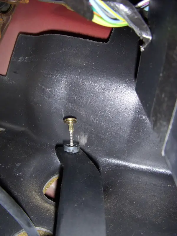

Looking up at the throttle pedal lever, you'll see this
Pull the cable tight, wrap a zip tie, or 2 or 3, around the cable base for fix
actually there is supposed to be a spring in there but as of yet I haven't seen one in any I checked for it.
attachment.php
I did that, same results. The quicker throttle response felt like 20 more horsepower.
