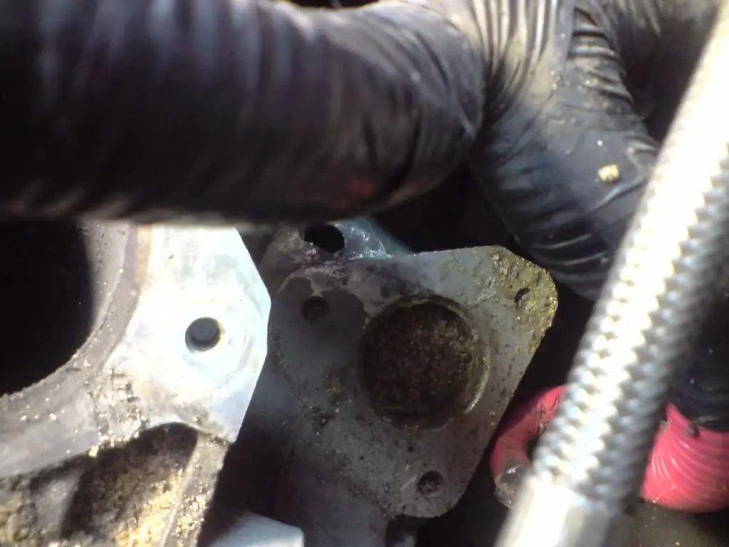

The upper and lower intakes had been taken off so I inspected the back of the head and found a small hole. I poked the small hole with a screwdriver and ended up with this
I have just put some permatex cold weld and a bolt in the hole and covered the head of the bolt and surrounding area in cold weld.

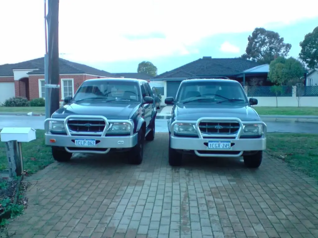

I see a nice looking front bumper.. can we get some pics of that thing.

Can you get some better pics of the head and the area where it is leaking?
And is this an OHV or SOHC engine? From the one pic I think it is an OHV 4 liter...
Sure thing. I will post pics of both my trucks together. Both have the same bull bars.
is that just a rusted out freeze plug?
im not sure what im looking at in the pic there
4.0L SOHC
No it's just dirt. I actually thought it was the plug before I looked and was very hopeful I was going to fix it for $1.
This is where the thermostat sits if the head where turned around and used on the right bank.

Here are both together the '98 is on the left.
:thumbsup::thumbsup:
You have been very busy fighting serious bugs. Good job . Nice looking fleet you have there!!
Those bumpers are huge. I could go deer hunting with those!!
I am very happy with my repair job. Not bad for $10. It is holding well so far.
My dad was in the air force and he told me they used devcon (similar to what I used) to patch up aircraft. So I shouldn't have a problem using it.
I know it's not permanent but it potentially could hold up for a few years. Even if it holds for a say 6 months I could just patch it again. It only takes me a half hour to pull and replace both intakes now.
In any case it gives me time to think about whether to do a head swap, engine swap or trade it in on a new car as we need to update our run around car. The engine seems very good and I think the timing chains (components) have been updated as it has no rattle with 230k klm's on it and it has the updated OOM12 screw in tensioner.
