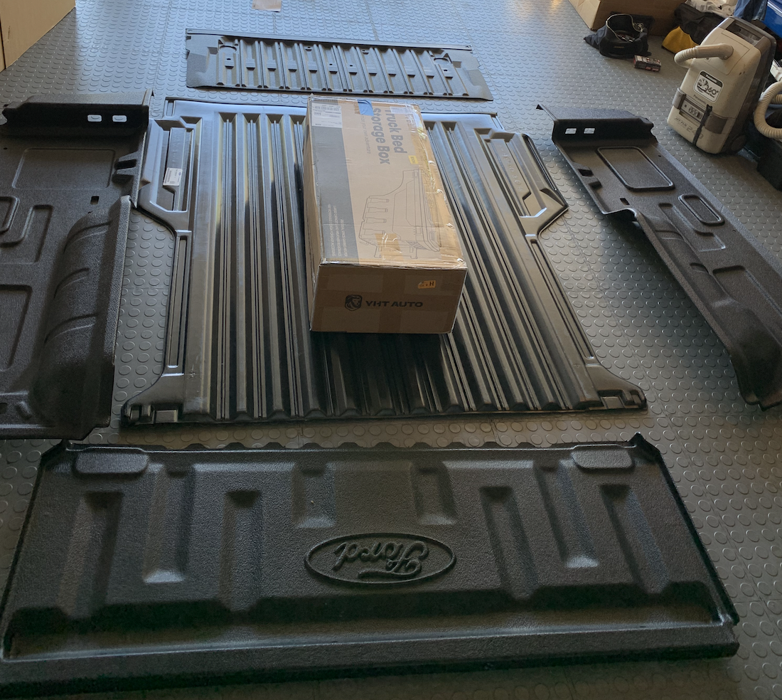

1. Open the box up, should look like this (minu the toolbox) & come with a bag of hardware

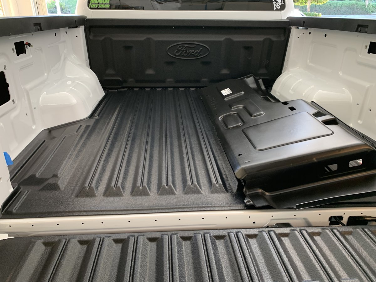

7. Tape the brackets to the bed (you can see the tape in the corner) Slide the bottom liner (the big one!) underneath the front liner and above the bracket.

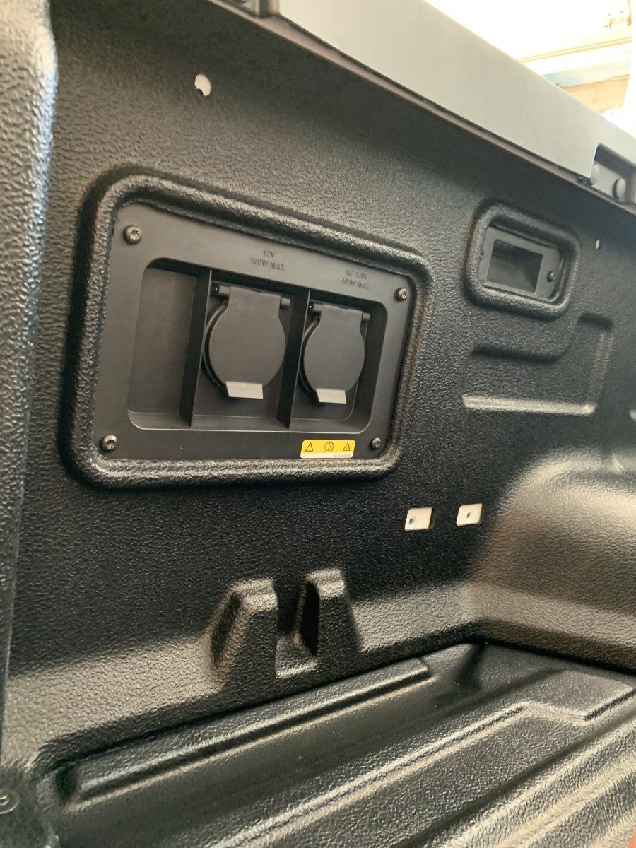

8. Cut out your power points & lights (for the PP, use 1 3/4 hole saw ont he 4 corners, then use jigsaw to connect the ends (or use the jig the whole way, if youre so inclined!) (For the lights, use 1 1/8 and connect ends) (The hole saw is to get the 90 degree arcs on the edges of the cutout. It is a tangent line of sorts, here is a representative image)

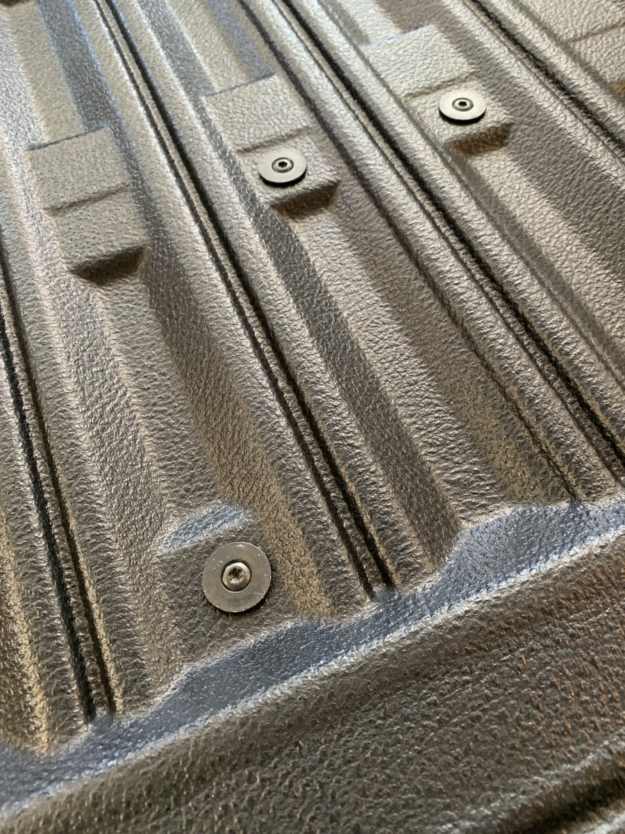

9. Push these pieces into place, first push forward, then bend the edges under the rail, and the end (bump tab?) on the rear corners, bend udner the molding. Make sure the holes line up w/ the pushpin holes & tie downs

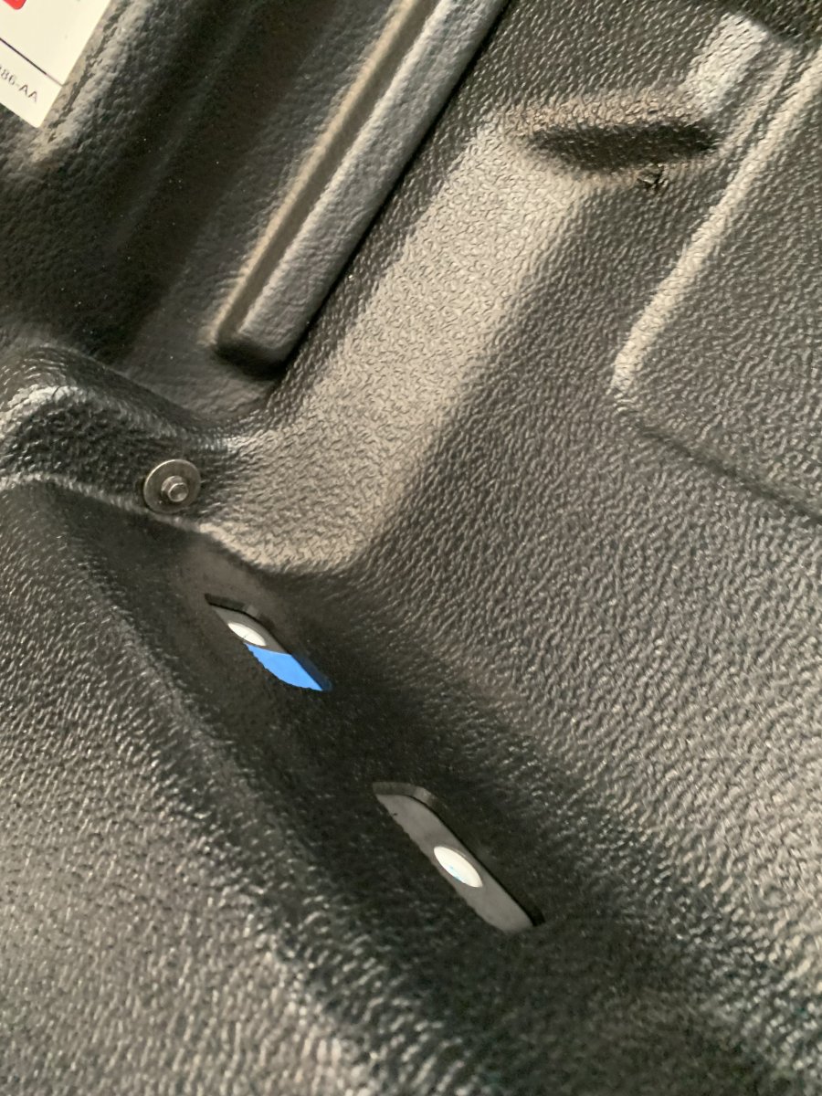

10. Use the pushpins and there should be 3 on each side, 4 on the front.

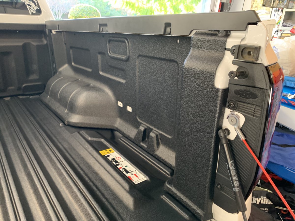

13. Look at the work you did!
