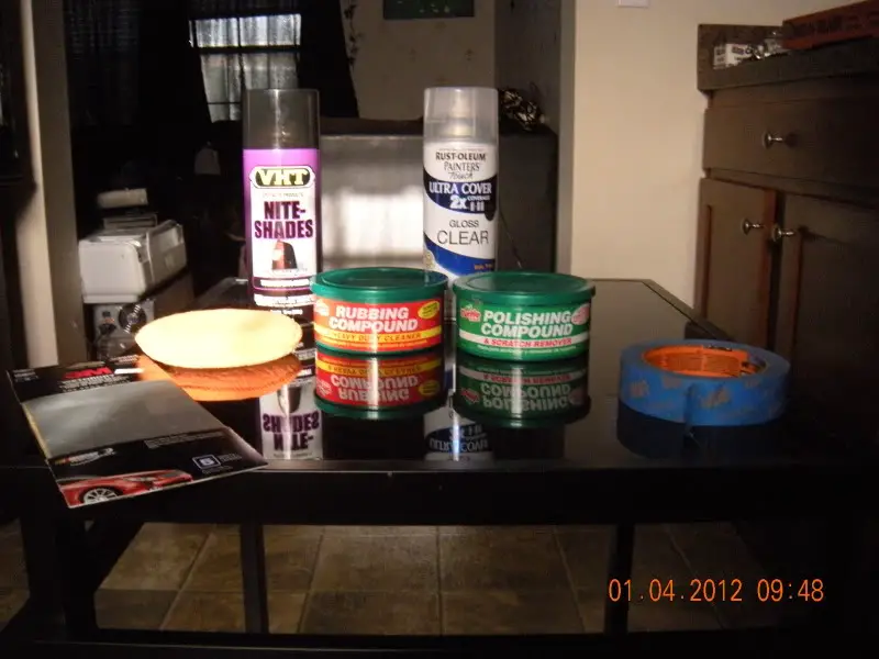

First you need ALL your products.
Can of VHT Night Shade
Blue tape or any edge-locking tape
Rubbing compound and Buffing compound
Clear Coat UV Paint
Pencil or Pen
Carpet Knife or X-acto knife
2000 Grit sandpaper
Dupli-Color prep wipe (optional)

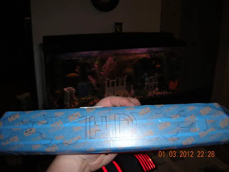

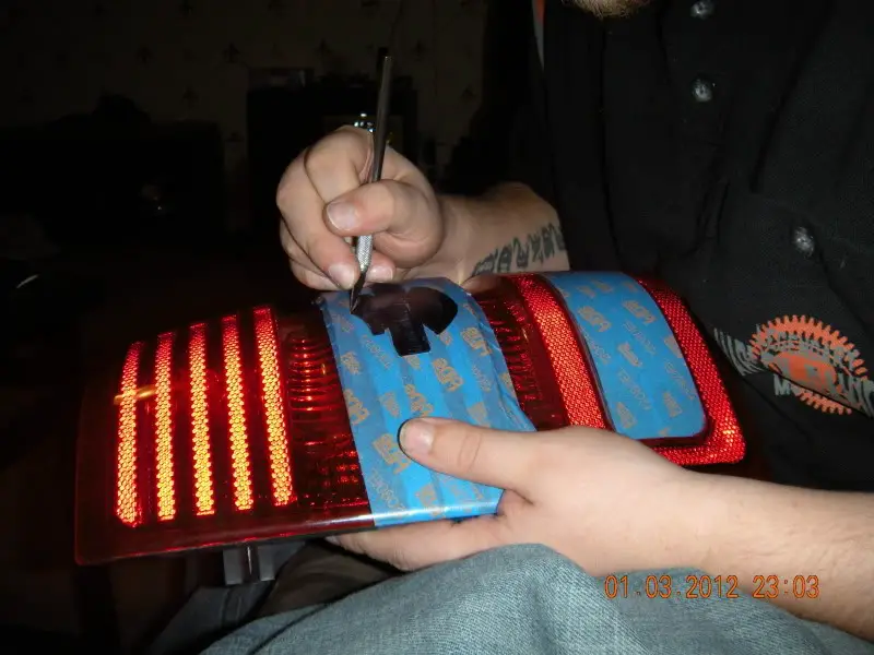

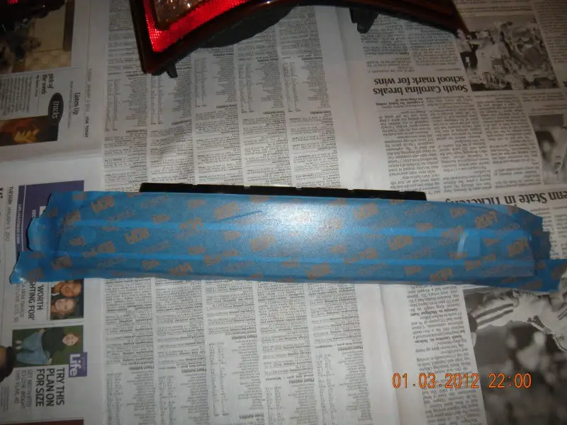

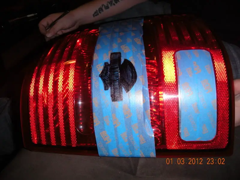

Completely Tape off the area you do not want to paint. I did a custom look so I taped off the whole area and removed the parts I wanted painted.

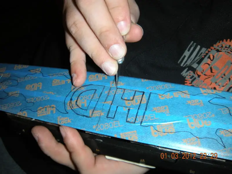

Than draw what you want to be visible
Using your carpet knife or even better an x-acto knife, follow your lines you drew
Remove all the tape except the viable area

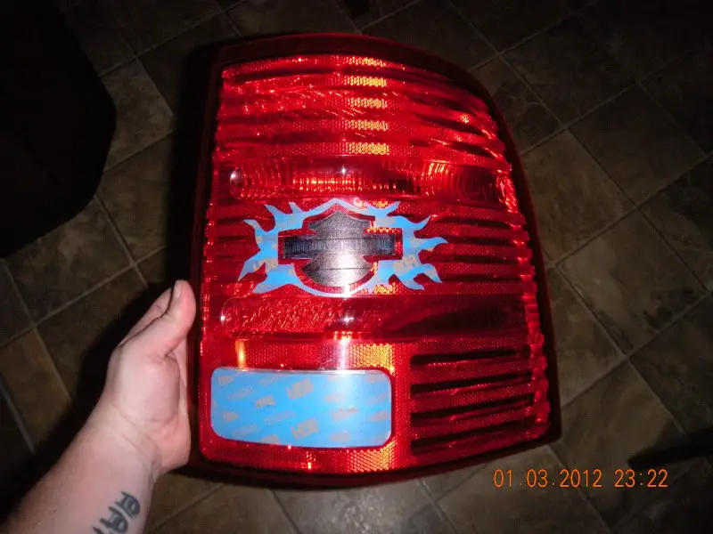

Then paint! I suggest doing light coats, if you get it too dark for your liking than you have do do it ALL over again, after you find a way to get it all off! You can always add more. I used 3 coats on mine.
After they dry sand it all down to get it all smooth. Once you are content, spray your clear coat on, once again I used 3 coats. Sand them again.

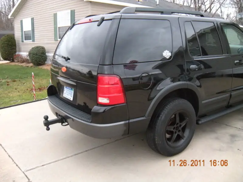

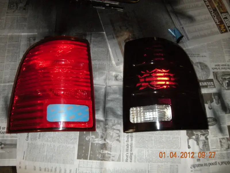

Stock

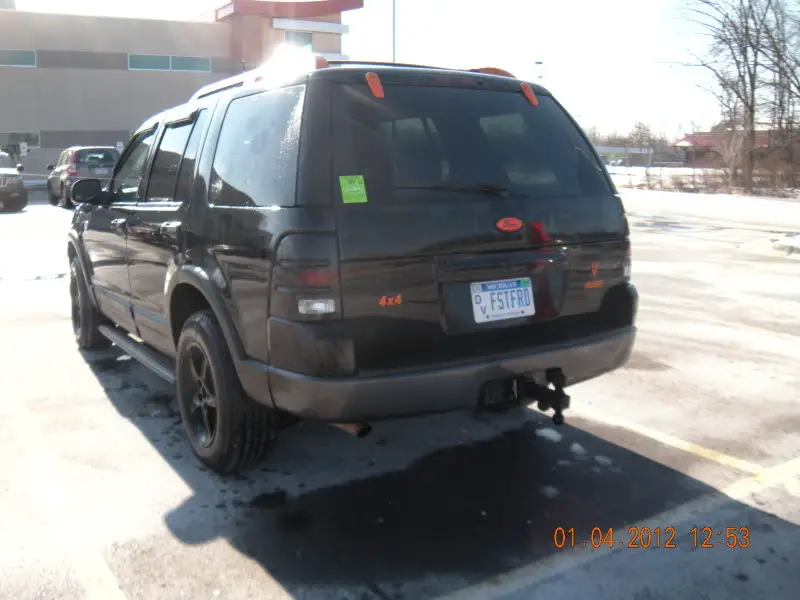

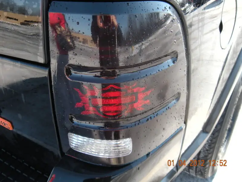

Custom

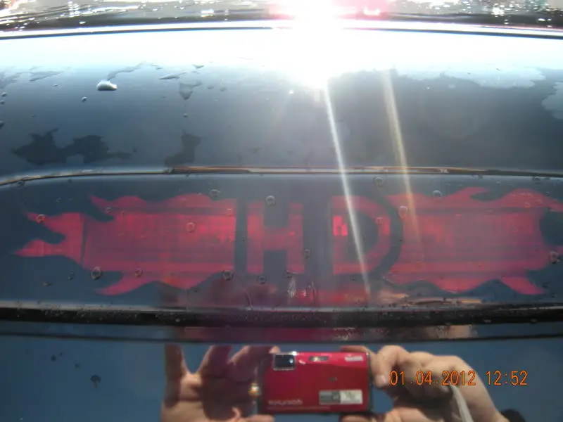

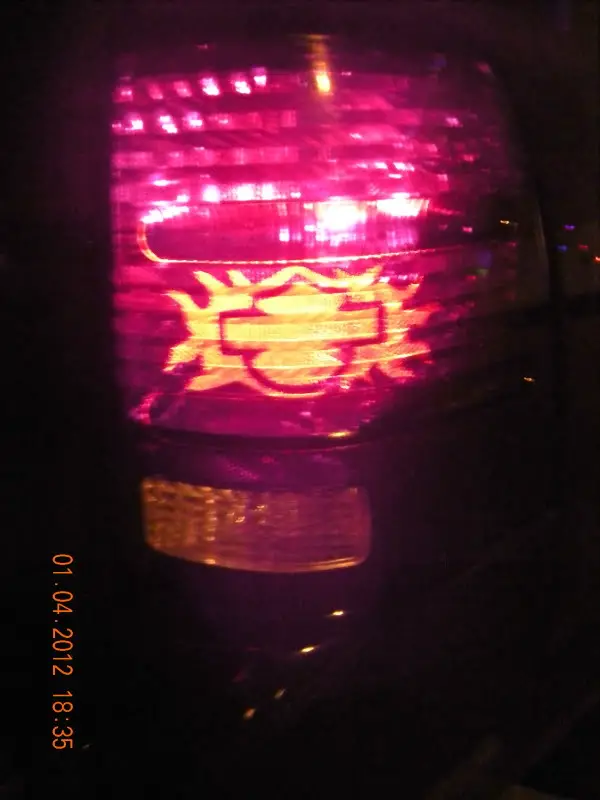

Running Lights

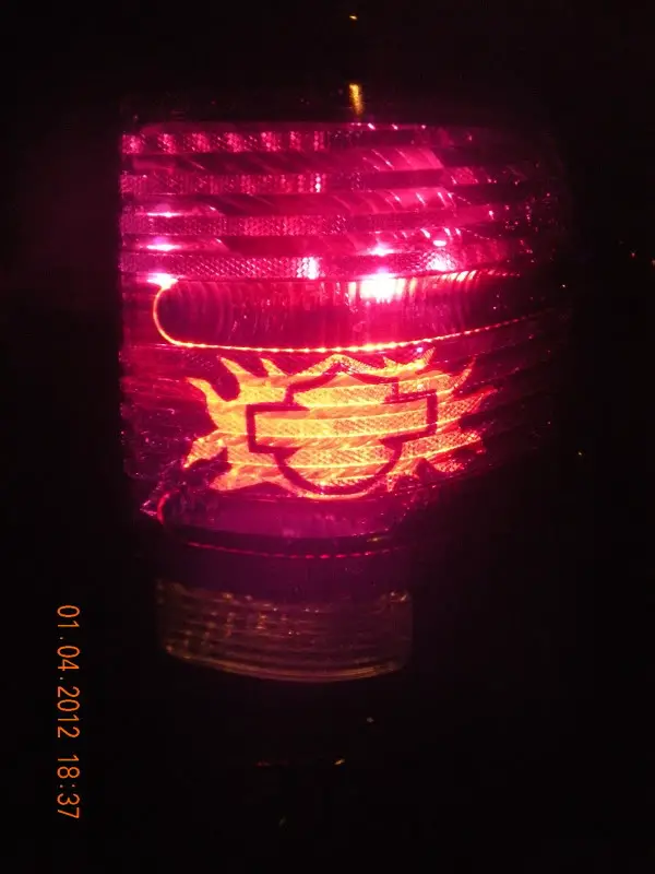

With Brake

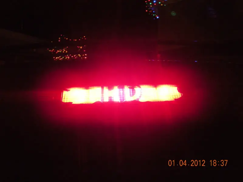

That's awesome. It might just be the pictures, but it seems like during the day that could be hard to see and kind of dangerous. Is it just the pictures?
Yeah, it all shows up just as bright. Where I put the Harley logo and such was right over where the bulb is. That is why I did a design was so you can still see the lights so I do not get pulled over or rear ended.
