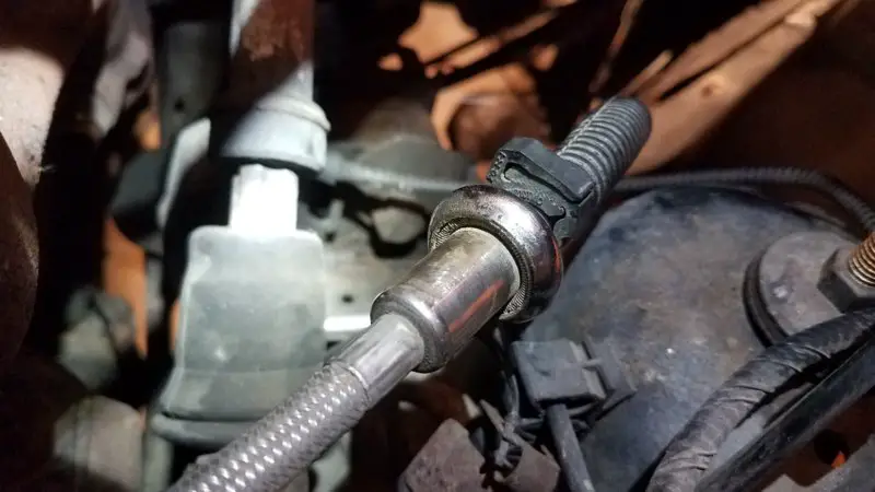

How does someone disconnect this?? Just man up and pull? 2001 Sport. Its an early model 4.0 (basically a year 2000 engine with 2001 body style)
I need this back on the road saturday and I'd be hugely grateful if someone explained how.
Thank you shucker! I didn't realize i could use a disconnect tool like the ones for fuel filters on this connection :rolleyes: It came right out. We all ask dumb questions from time to time...right? lol
QVSMJ4KCx7Bcxy33RTauXLNRjligWlLzn7R2hD9DDE-q1aZemr13u0IKUG-0rrh7cdOjZZe2d_JvX1uAEnWHwC_xjXp2aQGR6zsJfiQFMYXzzBQD0gOAlQnRMiRZ42F7MA4hGiThmjinm9yQomNz9rHe17wHprmi9atT_h1rAZ8KBIvfveJa8jIYHDpjZoIAPw-21jSFEKzaZ5eQHSmG6ydF1Hm1Di1GyAgvBeU5RHQy7hpe9sMsSLzq1UEDIz9S_D4dd68WU1vZ9BFssRtCk1PvpPOYaKwgnGO8TPX735XvbxlNPYNQvQvCju22_AmghcR-SQ6dQGn_CtAmLmuoRBCIHvXvtSCEYArZFiOcmqNU_Ft0FO34s61Tft-A9vfe-5f7MQm_B3UFuRWPA-SiDryZtpQs5Z6uwx5P7spOown0IsjlQxcqGFOMa7XqRiWhtYfIDtJwyjhp1HIo1QJatKLU6e6wPIJLCL6nX4tzirQmZvI-xGRsUmnTm6lOBf9OSUz0G7I-bjNhhGrrFBrysCePspYn7dV8j6tDbzUh7OxwGBMspN3v0HEyigdkRjcX1c7guqH8ut9eR9SU-WHBaAO6rWPYaurVpEDGdMkpiJZIBwFgEHmRtdnPWfr0VKf6ZKI_uVFFUG71x4moCcROOgghSrqGioc=w1263-h947-no
I used these for the fuel lines on my 97, they were not my first choice, as my first choice where the cheaper ones that I fumbled with for over an hour and would not work (flimsy plastic). Took them back to the big "O" parts store and got the ones in the picture. The rainbow assortment of sizes in the picture cost more but work great!
Lube The o rings on the inside of the connections
