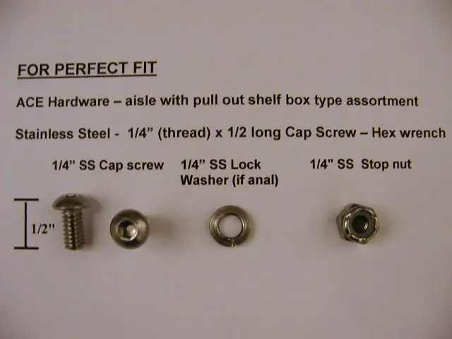

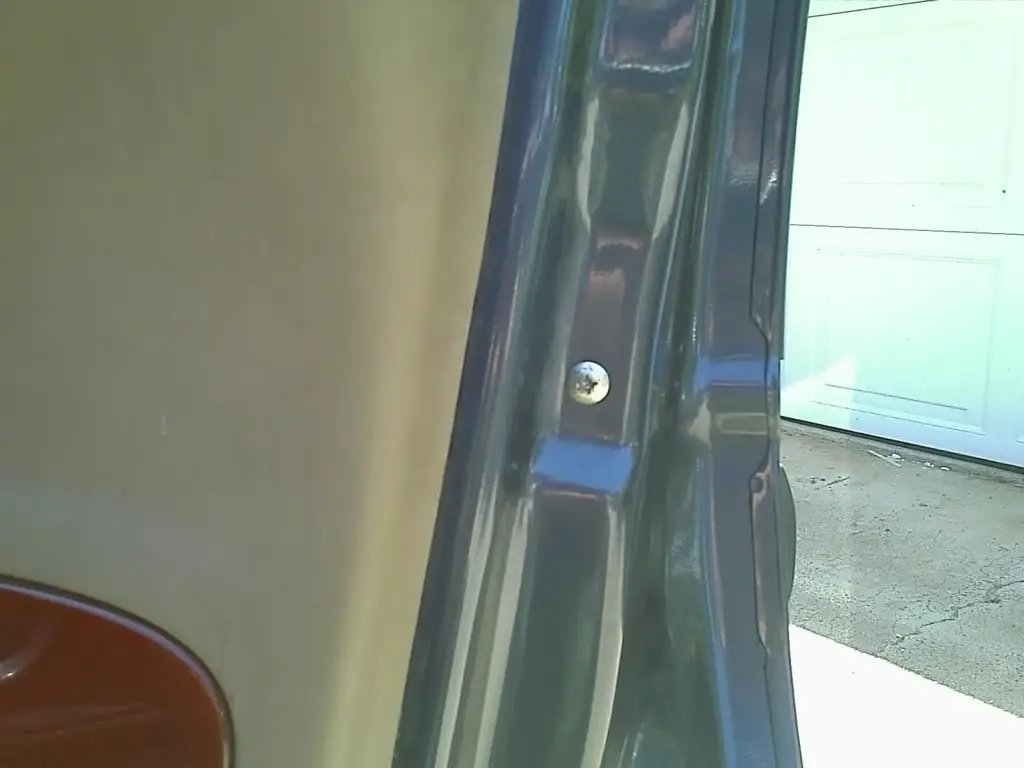

I used these Stainless screws in the photo below to prevent getting rusted. I ALSO recommend lifting the handle and placing a thin cardboard beneath the edge of the raised handle. This allows you to let it rest on your allen wrench and not get scratched while you're working to get the nut on from the inside. Once the nuts get threaded, a socket and extension (prepared in pocket) will just slip onto the nuts from the slight angle - no swivel needed.

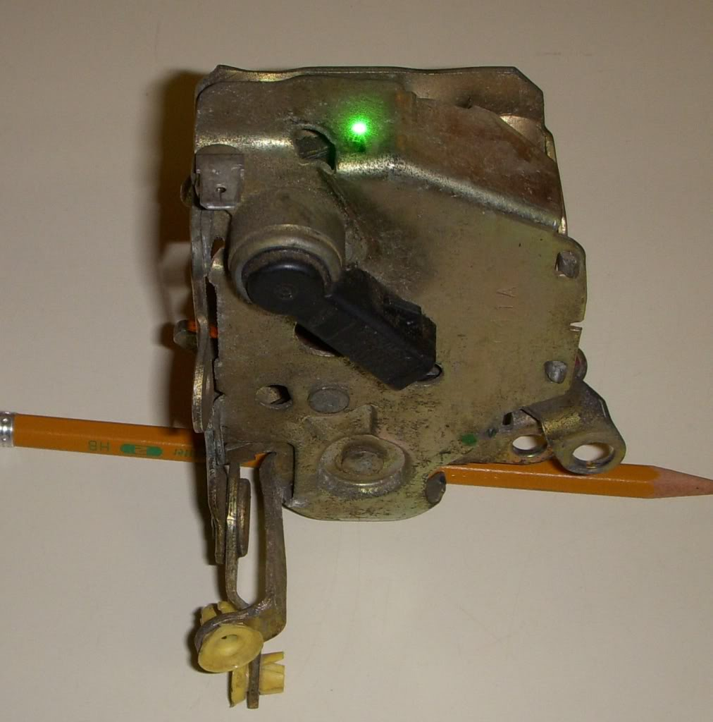

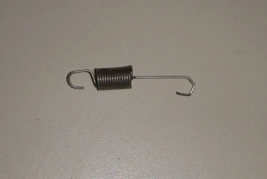

O.K. here are some pictures of the fix. First is the latch from Ford, NAPA did not carry it it cost me $45 plus tax.
If you elect to fix it your self here is the step by step.

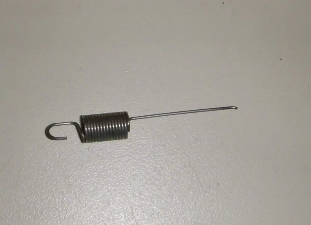

The spring, the coils are about 3/4 inch, the tail is about 1.5 inches long.

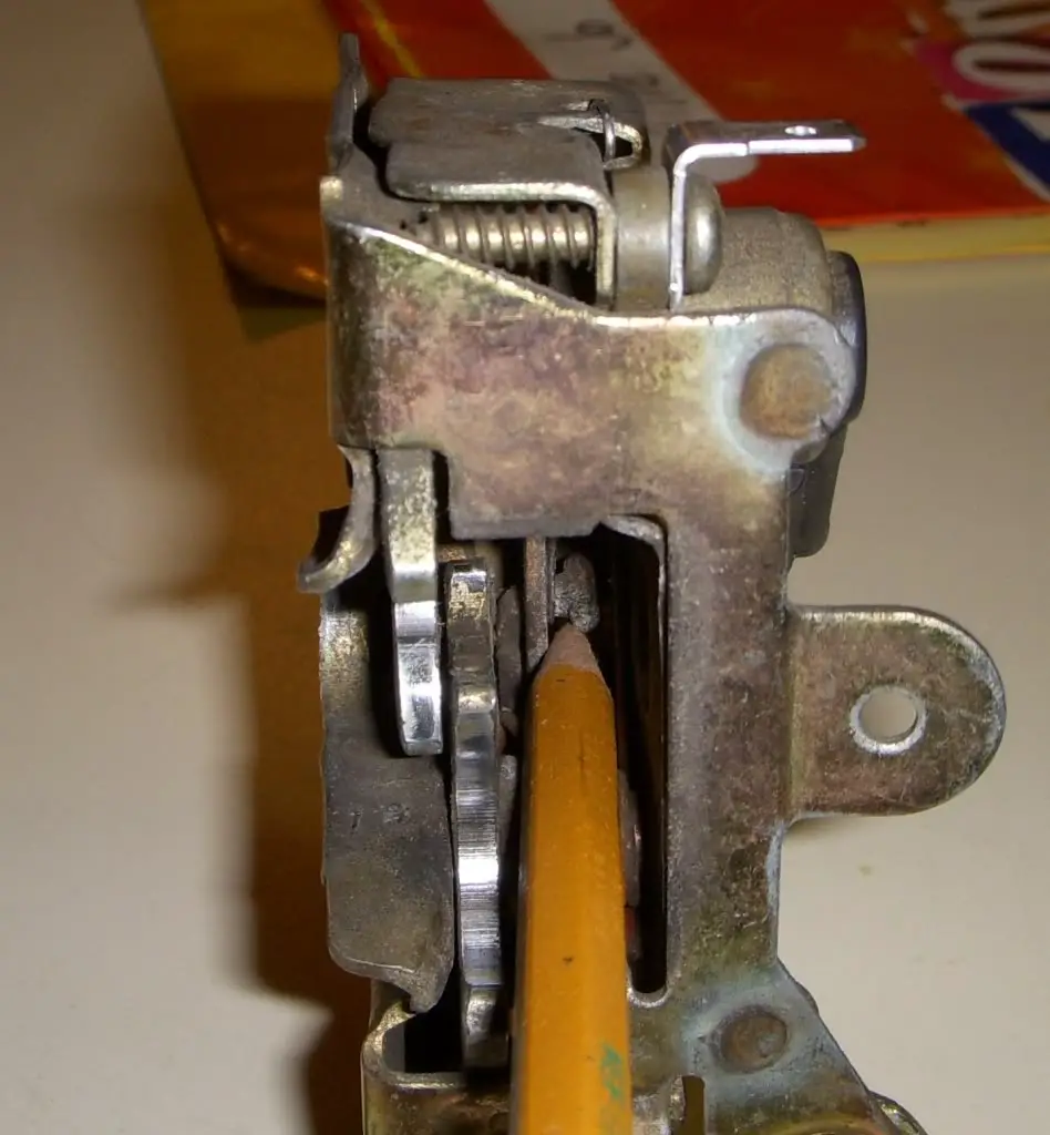

The top of the latch box is where this is conected, the green laser marks the whole.
Do your self a favor and use a nice pair of heavy forcepts, the hole where the spring goes is pretty small and a pair of neddle nose juse will not fit.
if you are trying to bend the old spring use as little of the shaft as possible, the longer the better. Bend as shown.

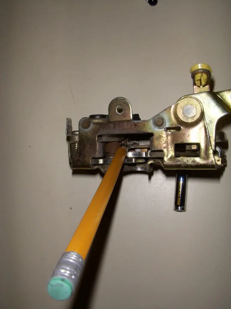

Hook the short side up around the body of the latch that was highlighted by the laser, using the forcepts. Then using a dental pick hook the bottom around the tab that the pencil is pointing to in the next photo. note that you can see the top of the spring hooked around the top of the latch body.
This is what the finished spring placement will look like. If you can find a new spring, it will not be so stretched. The mechanism worked fine and is ready for install.

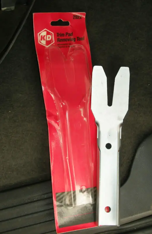

1. Remove the inside door panel. I splurged and bought a door panel removal tool, about $10. I like it! But not necessary if you have something else that works and you know what you’re doing. Carefully fold back the weatherseal foam sheet.

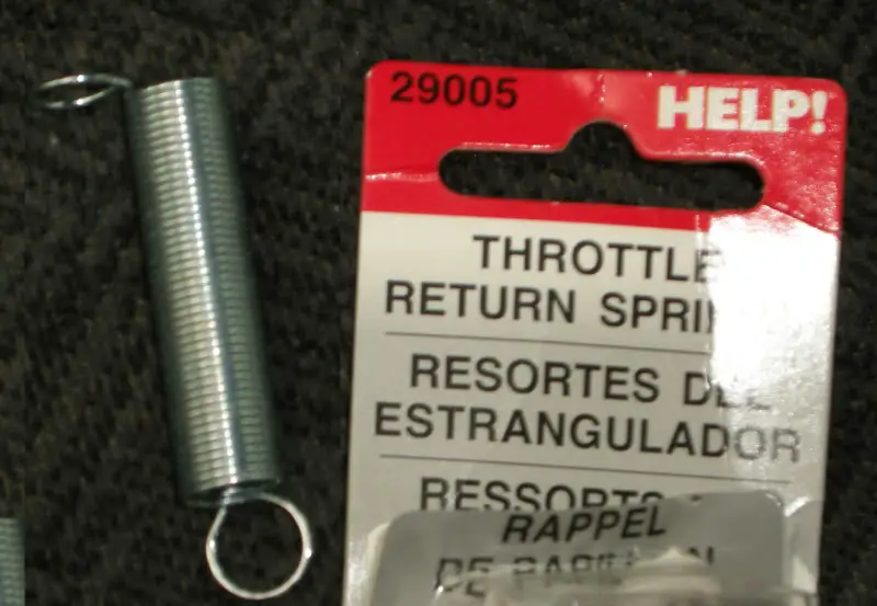

2. Find the yellow connector block, lift it a little and verify that it is the problem. It was. I bought a Help! throttle return spring and used some zip ties to hook everything up. Make sure that whatever you use to "respring" that yellow block does not interfere with the window up/down travel. And, it does not require much upward spring force on the connector. The outside door handle moves the rod going to the connector downward when you lift the handle, and you don’t want to interfere with that. You just need a little lift on that rod/connector to allow the pop-up button mechanism to do its thing. Note: I looked but did not find any broken spring in the bottom of the door or anywhere else. I could tell someone had taken off the door panel before me, probably trying to fix this problem.
3. I attached the new spring to the backside of a peel rivet that secures the outside door handle. It was in a good position above the yellow block, and would be out of the way of the window glass up/down travel. I used needle nose pliers to carefully pry one "wing" of a rivet away from the door panel a little bit, hooked the spring loop over it, and used a big flat blade screwdriver to push the wing back against the door panel to hold the spring in place.

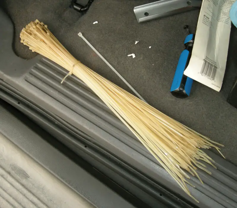

I used a ziptie which I lassoed around the yellow connector and tightened down and trimmed, and put another ziptie through it which I looped through the bottom of the new throttle return spring and tightened just enough to put a little "lift" from the spring on the yellow block. Tried the lock mechanism to test it- It worked! Tried it with the key in the lock also, and the unlock/lock button on the door, and the remote fob. Cycled it at least 30 times. Worked every time! Also ran the window up and down to confirm no interference. Did my Touchdown/ End zone victory dance in the driveway. Re-assembled my door panel. My total costs: $10 tool, $3 springs, zipties I've had laying around since 1980 $0,time: about 45 minutes.
