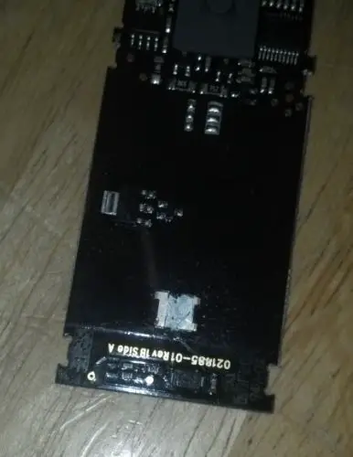

3rd row led
Ok so I have led in my third row however what I did is not for the faint of heart however it was truly easy. So I took apart the third row like others have before and I started to look at the led and decided to fix it. Little about me I am not an electrician I am an army aviation mechanic so with that said I am not a subject matter expert I just make things happen that's the army way. So looking at this board I made a decision if I break it I don't need it. So I began by scraping the first layer off the led (the white stuff and the light) till I got to the first layer of metal that was split into to halves and I noticed there was some small metal tabs on the sides of this plate. So I took this board back to the explorer and plugged it in and started to touch and led to it and it lit up. I then made plan to get this whole thing to work and I want to show you how but I can't put attachments on here. So I took apart a 5 led 194 wedge bulb apart slide it through the reflector and put the wires under the tabs and bent them down snugly. Holds really well I then installed the board back into the case plugged it up and the whole things works beautifully looks awesome with all lights being led. Down side I still get the ten min lag sometimes that I use to get when I had all stock ones but I can get it to turn off with the instructions from the post above

Ok so after you scrape off the white part of the led and get to the first layer of metal it should look like this
As you can see I did not remove the entire led just the white part and the light. And you can barley see the small tabs on the sides. I used a 194 wedge bulb that I took the bottom off the light.

once you have the reflector its time to assemble. You have to figure out which way your led will turn on so what I did was take my led and the board back to the ex and pulgged it in touched the led leads to the scraped metal noting which way it turned on. Now unplug it and time to finish this. You have to now thread the led through the reflector make sure you have the reflector the right direction so it will reconnect. After that slide the leads under the tabs qnd fold the tabs down. Make sure you take up as much slack as you can. The bottom of the reflector will end up sitting over the old led pad. Next adjut the led so it goes down as far as possible should look close to this.

I suppose you can solder it on but bending the tabs works just fine. After you get it locked in and led adjust you have to snap it together make sure you line up the reflector with the housing tabs and be careful not to crack it.
