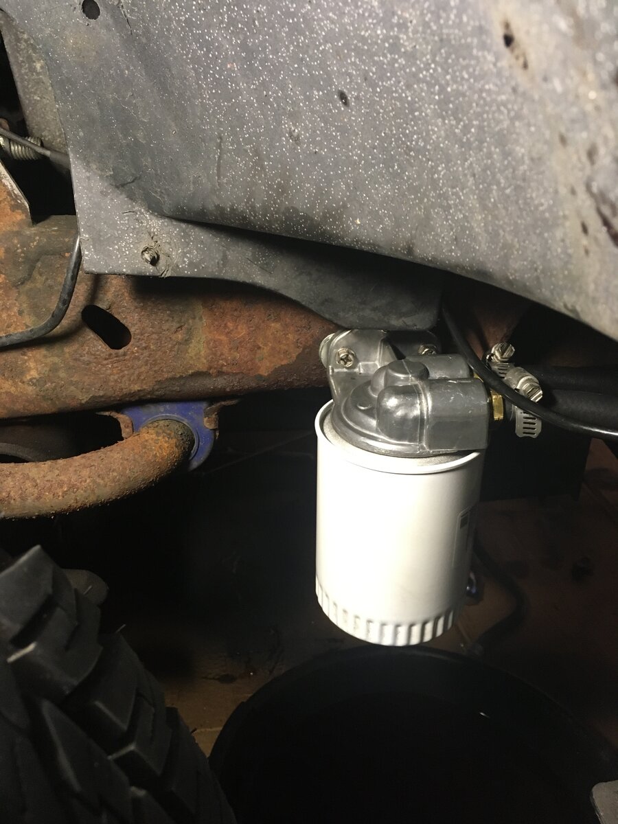

I installed an external filter on my 4R70W, will be going on my 5R55E when I get some time. It’s a remote spin-on that I bolted to the frame forward of the right wheel well. On the 5R I’m going to add a drain valve and barb/nipple as you mentioned so I can easily do a change.
