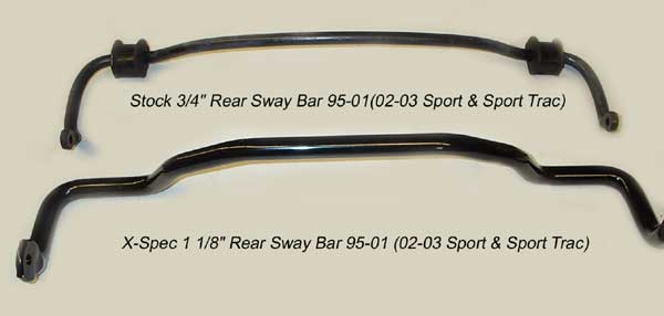

I think a lot of folks out there that would disagree about the performance potential of the Explorer. If you ever drove an Explorer with our X-Spec Suspension Package installed, you would change your mind.
The only way you could widen the track would be to install wheel spacers. We are not fond of using spacers. They will cause wear and tear on yours wheels bearings and will not really give a noticable improvement with the handling.
What we have done with the shocks, sway bars & lowering kit make a huge improvement without changing the track. Even if you do not want to lower your Explorer, the shocks & sway bars will improve handling & stability.
