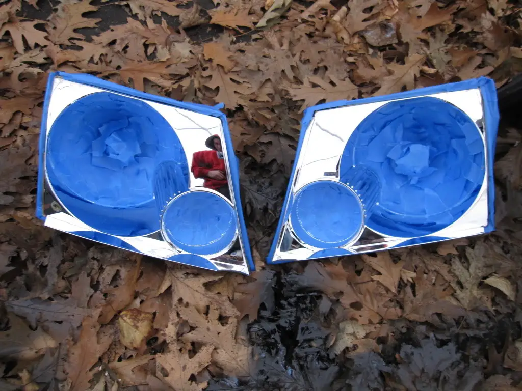

Prep work is the most important step to getting a good product. Get some painter's tape (I found that frog tape worked good for me; left a good clean edge). Tape off the reflective part of the light (I'm going to use fedy's picture here)
(Photo Credit: fedyfedz; pic from fedyfedz's registry)
The little part with all the grooves in front the high beams reflective area, I taped off incase it had something to do with the high beam performance. You can tape the headlights to any design you want.

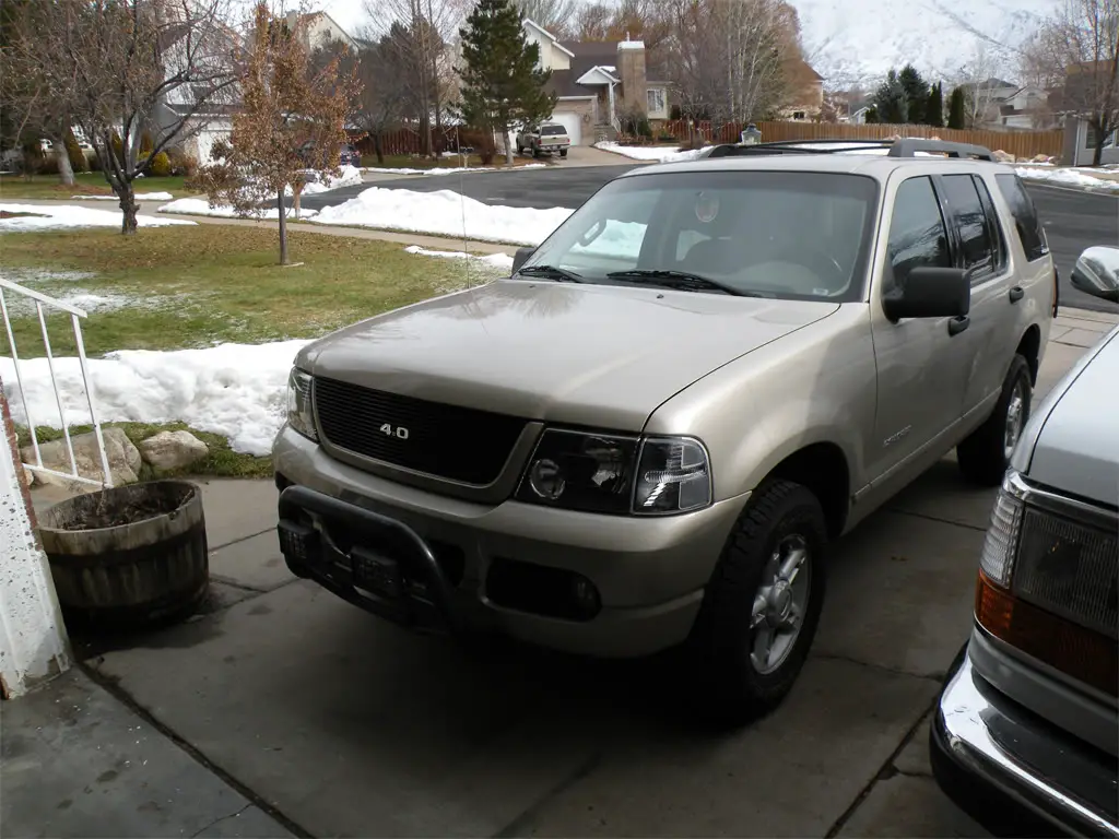

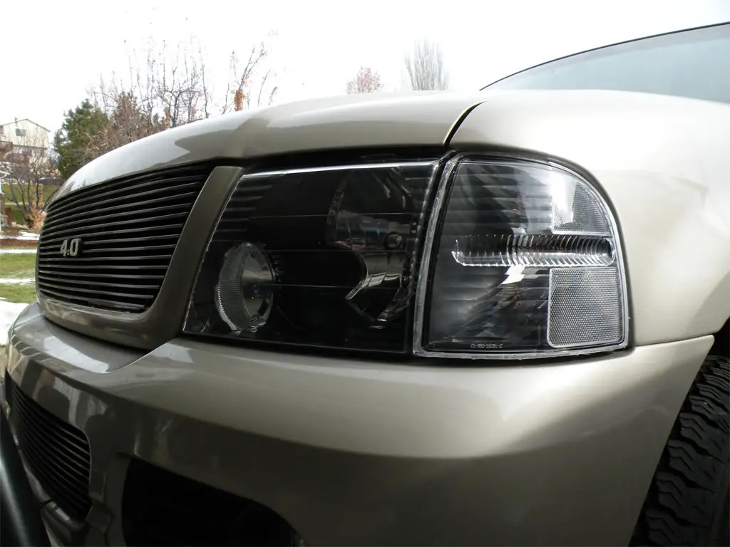

AFTER:
By doing this you have probably saved $80.00

Shouldn't the idea be to make the lights brighter, not dimmer?
From my experience, there was 0 effect on light output. Just don't paint the reflector (bowl parts) and you will be golden.
