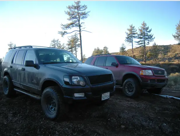

wow that truck looks awesome! :eek:

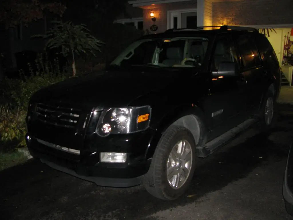

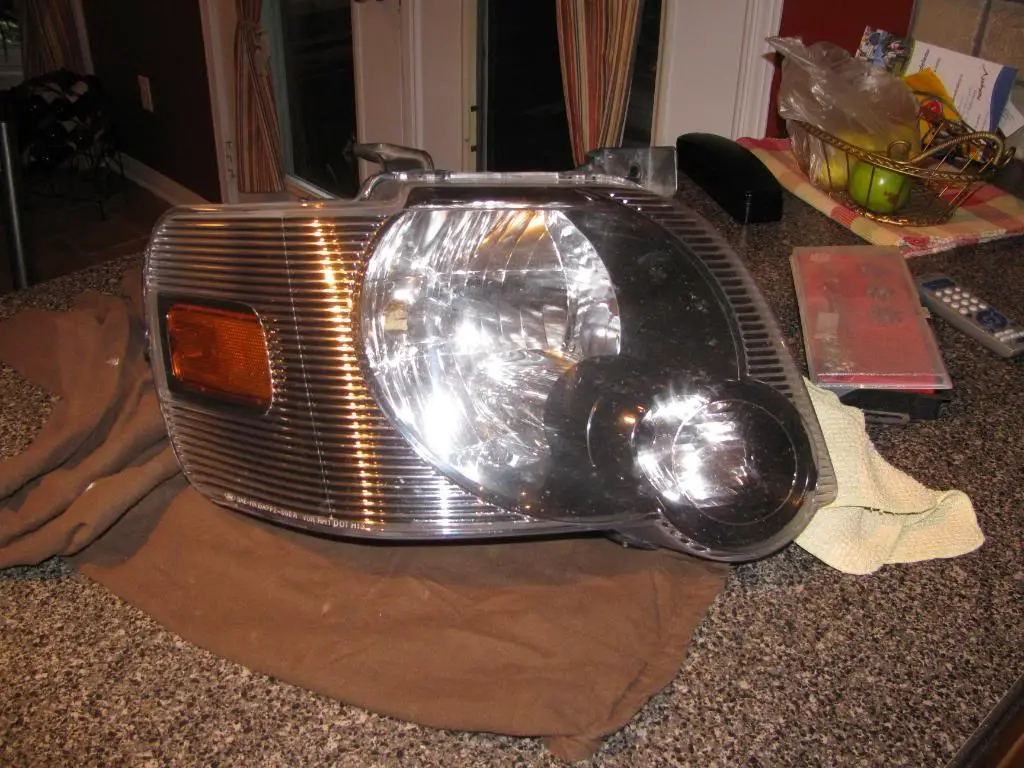

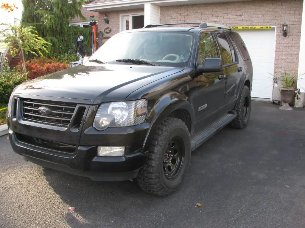

SO this is the finished product:
thats a film over the light. ours were actually painted and gave it that smoked effect
Its paint dude... I did what you did then painted the outside. Night and day difference. Heres some better pics.

Just now getting a chance to look back at this. I was going to say that if it wasn't a tint over the headlights then the actually lens had to have been painted to get that look. I've seen aftermarket covers and tiny films made to give that look before so I apologize for jumping to conclusions on it being a film

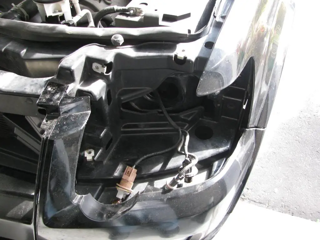

First off, you need to remove the headlight from the truck... you can see the three bolt emplacement on the picture below. For the bottom bolt, you can just untight it and remove the headlight by sliding it away.

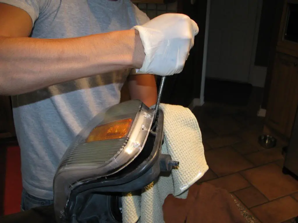

Heat you oven to 220 Fahrenheit and let the headlight heat for 15-25 minutes. Take a close look at the sealant every 5 minutes when the 15 minutes point is reached to make sure it's soft enough to work with.
Once it's done, hurry up and get your flat nose screwdriver to take the lens of the casing before the sealant harden's up again.

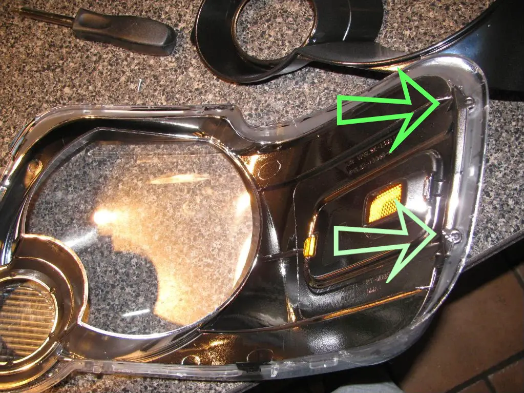

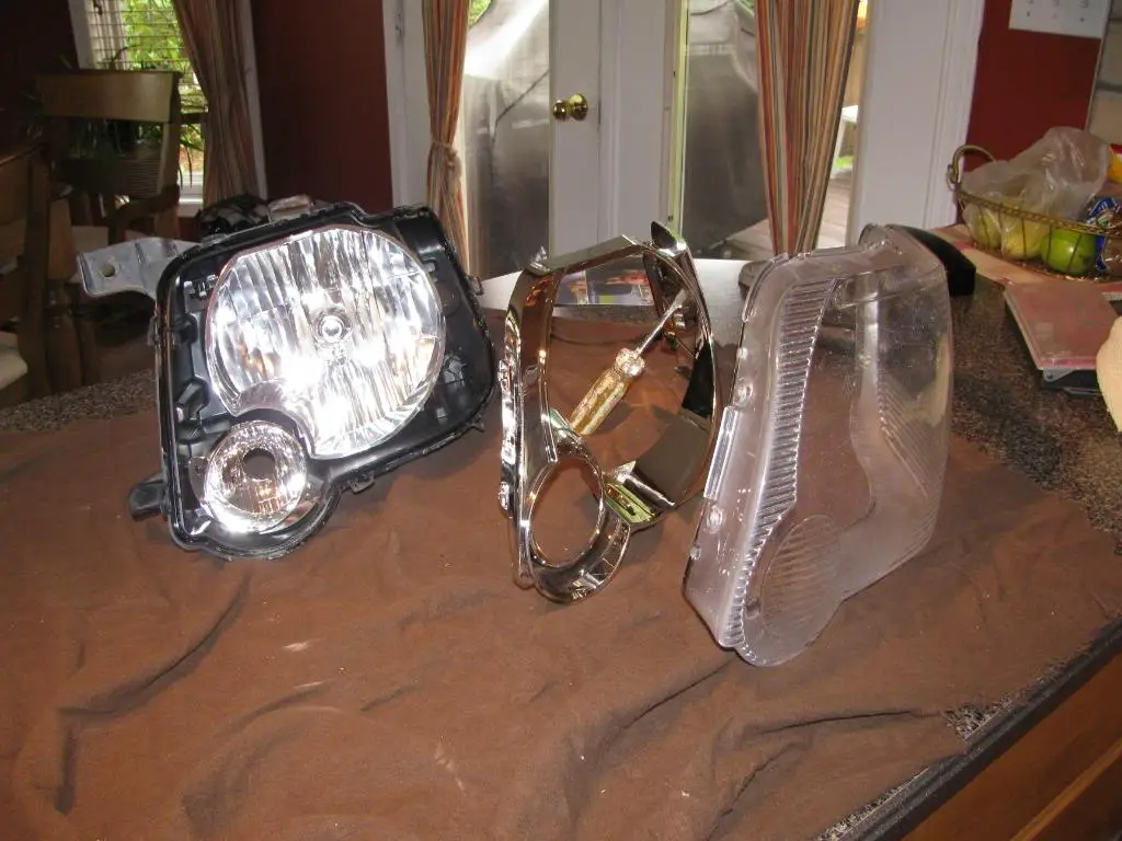

Once the lens if off, there's 2 screws you need to untight before you go further.
This is what it looks like when the lens is out of the casing and the housing out of the lens.
You can now do the same thing for the other headlight and then proceed to painting.

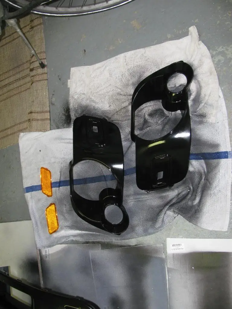

I used black Krylon bonds to plastic spray paint. I layed 3 coats for the housing. The orange reflectors on the side are just held by a small clip.
Once both are done, you put the housing back in the lens and then bolt back the two screws on the picture.

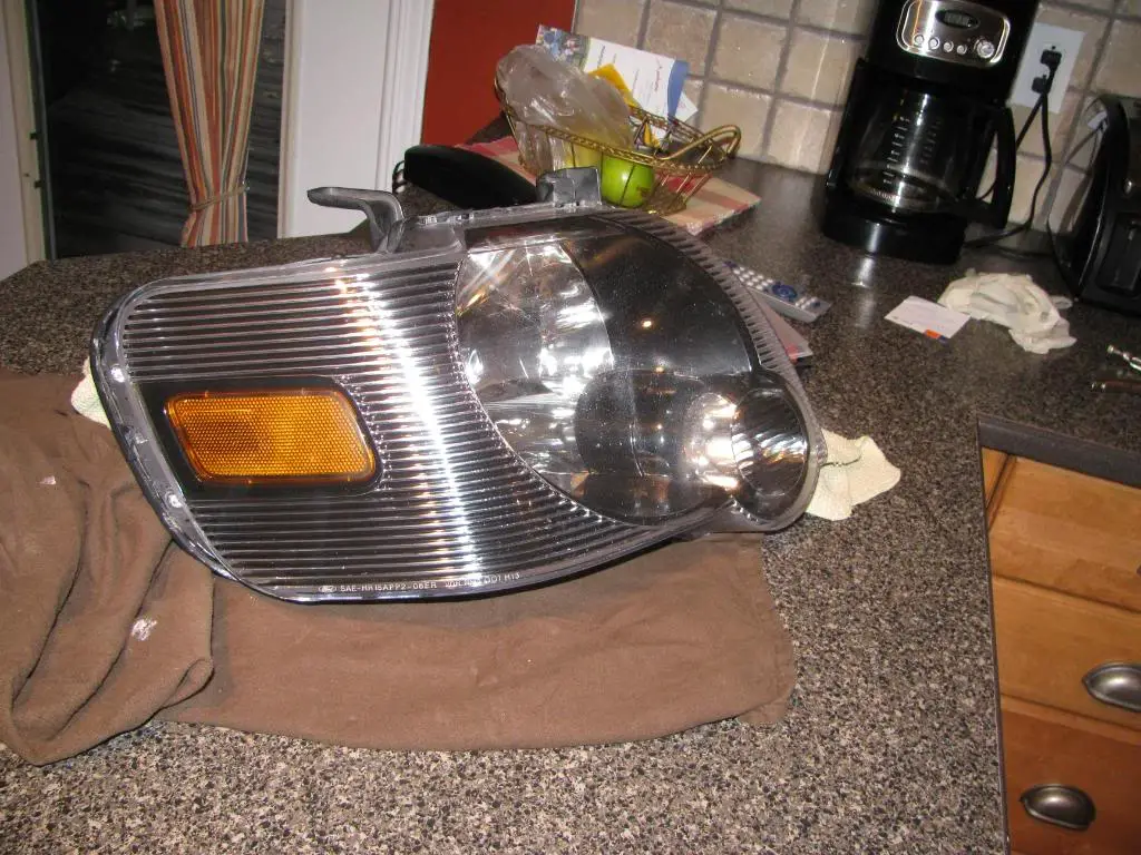

This is what it looks like when you take it out the oven before resealing:

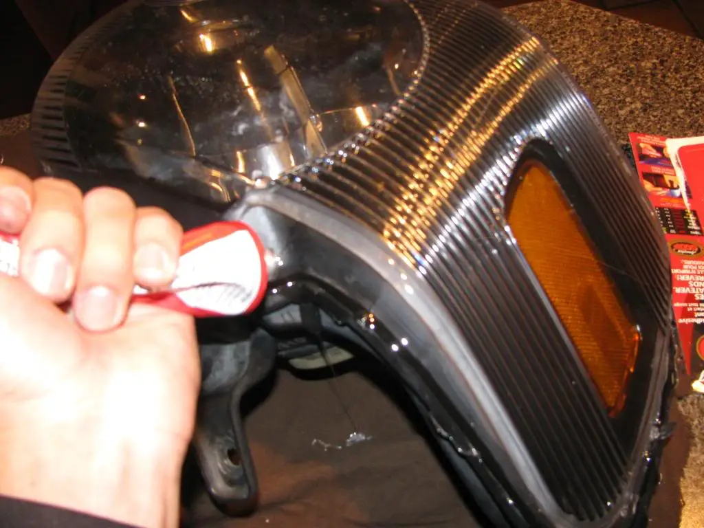

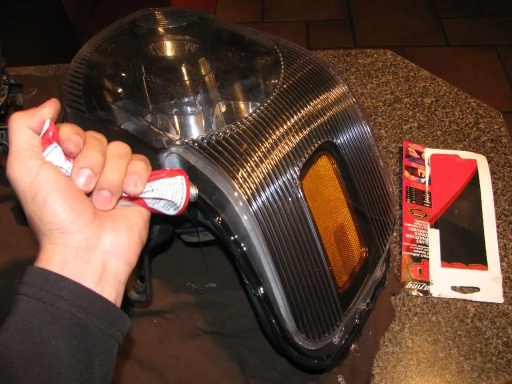

You can now seal everything back together with plastic sealant. You can never seal more than needed so make sure every single millimeter is sealed tight...
I recommend also to seal the 2 bolts on the side of the headlight.

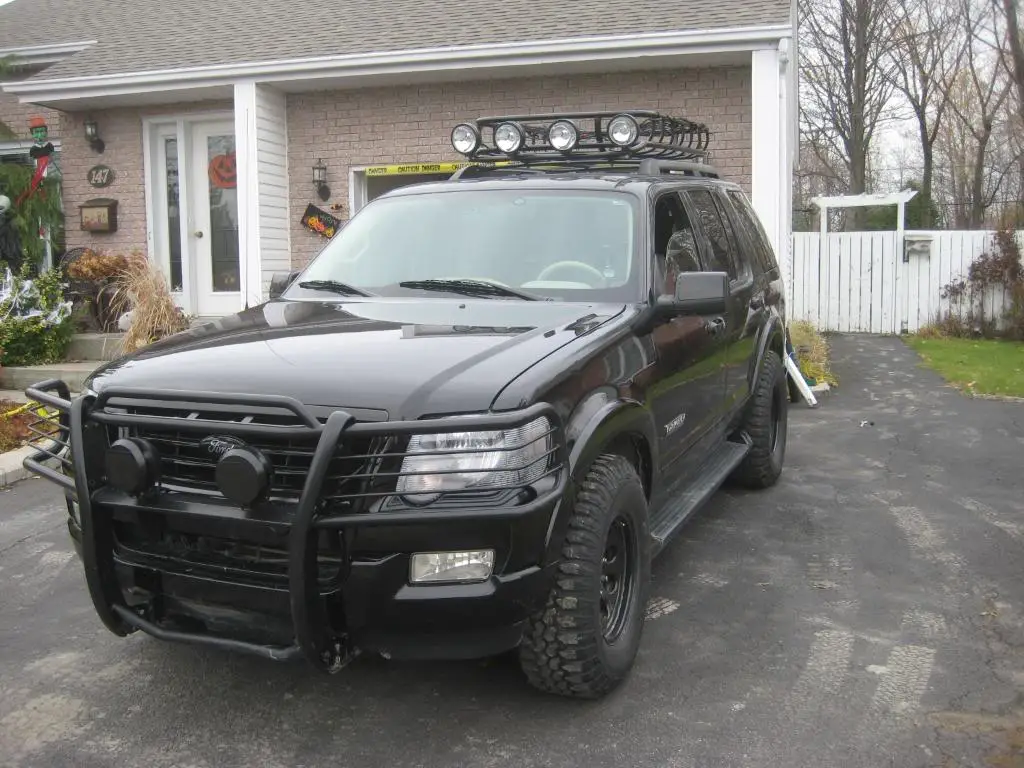

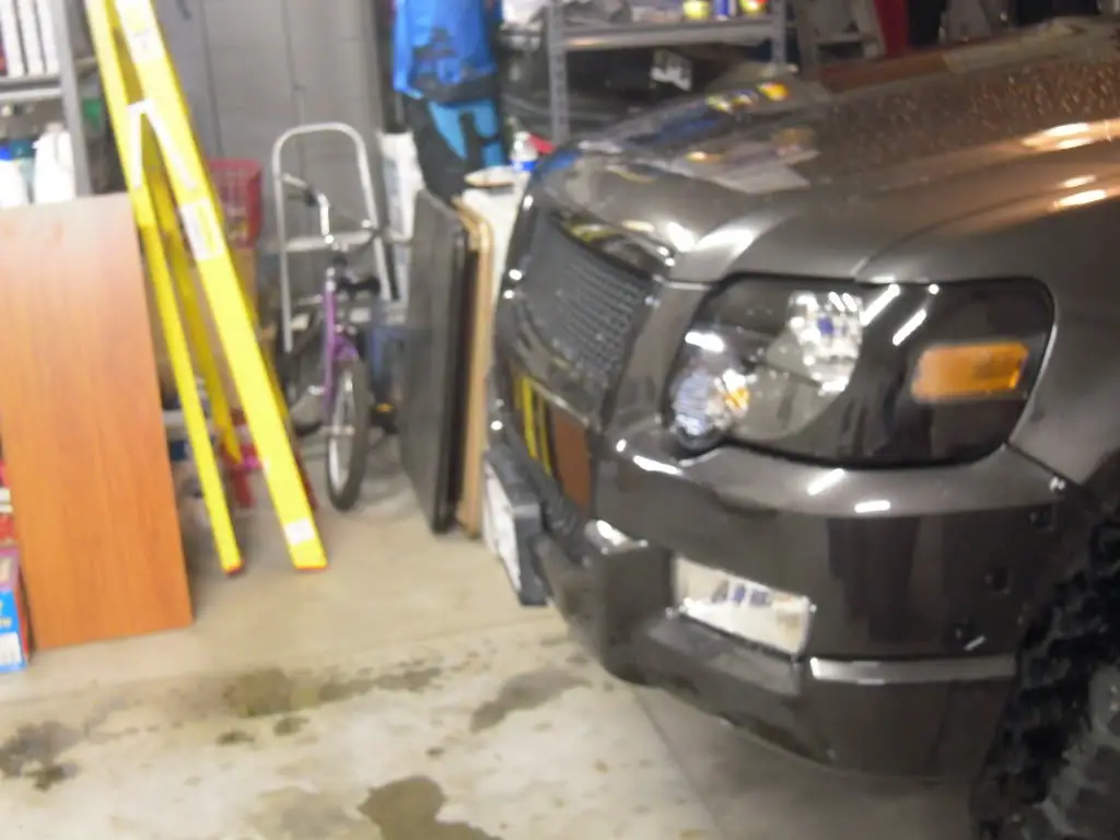

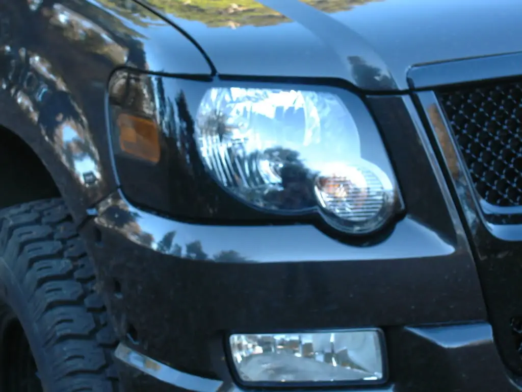

Once everything is sealed and ready, you can put the headlight on the truck and enjoy the look of your new black housing headlight!!!
This is the final result!
