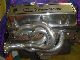

That's right, it's his money pit. Saleen_SR71, don't forget to send your original Headers back. We need to get the correct ones (Smooth Tubes) without the external EGR connectivity on the passenger side Header, as it appears in the attached photo. Some items may not cost anything. Thank you.
Bob Pasquale
Tech Performance & Engineering
Torque Monster Headers ;)
