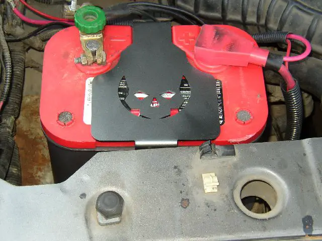

turned out great Ted! that is weird that we both did this on the same weekend with the same box!
Instead of grinding away at the factory tray (which after a few secs I decided I wasnt going to attempt to take out) I just cut the 4 outside tabs away. The box is secured with the middle bolt holes using grade 8 5'16" bolts with indented washers and nuts. I was amazed at how sturdy this box held the battery. I especially like the side tabs that slide into the optima casing.
