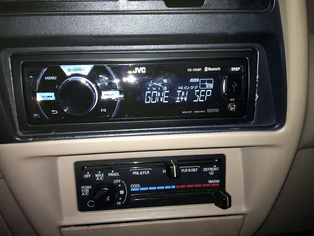

I picked up some new tunes over the weekend. I was fed up dealing with a beat headunit and dealing with CDs. I picked up a JVC X50bt media receiver. Has a few USB ports, aux in, and bluetooth. So far I love it.

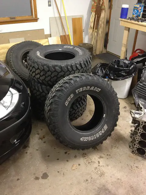

And the next chapter begins in the Explorer's life. I picked up a set of mildly used Pro Comp MTs in 32X11.50 tonight for a reasonable price. I probably won't get them mounted until next week but I should have had them done for tonight.
Bonus, frost pic after picking the tires up. For really worn tires it still does good in the snow.
Those look brand new. Pro comps are pricey new so I'm sure you came out on that deal.
From what I've read they should come new with 20/32nds on them, theses have between 14-17 depending on the tire. I got them for $575 so I don't think it was too bad. I was disappointed to see the siping in them isn't very deep. That was one of the swaying factors to getting these. Oh well.
