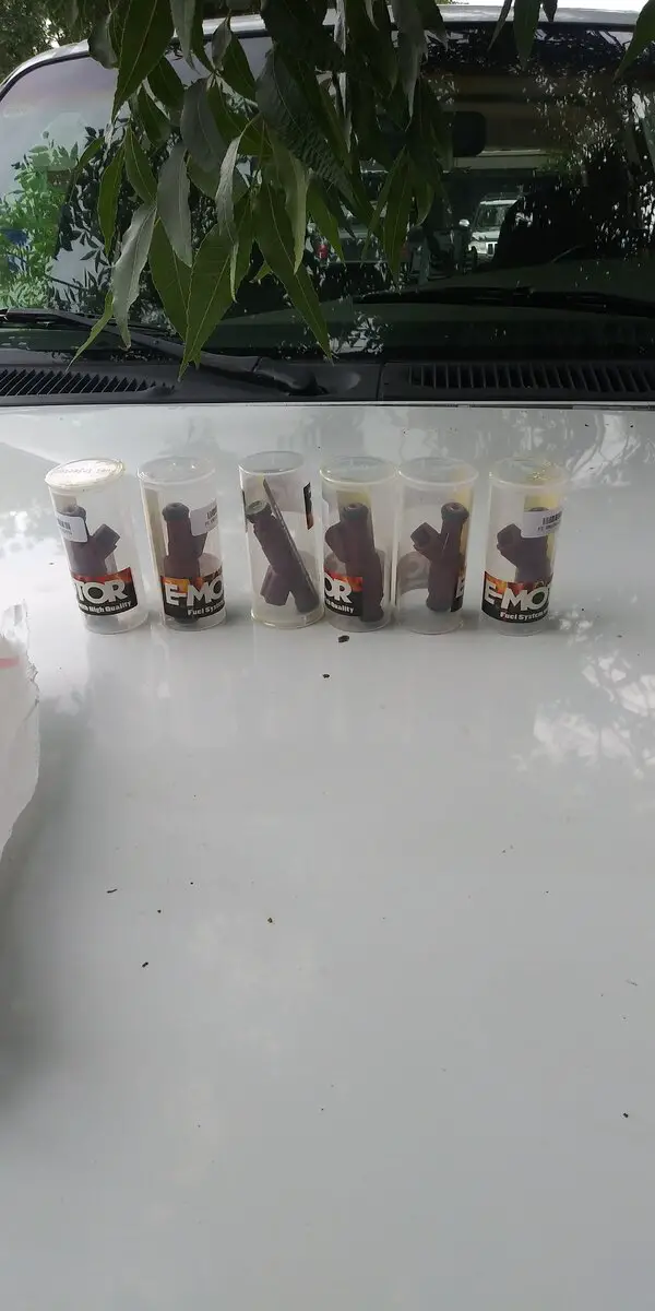

fuel injectors cleaned and new o rings they were seated and did a leak test no fuel came out ,

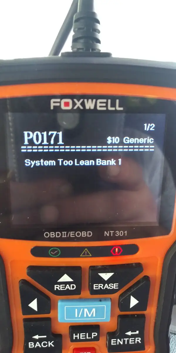

so i changed the o2 sensor out and now its giving me p0174 plus p0171

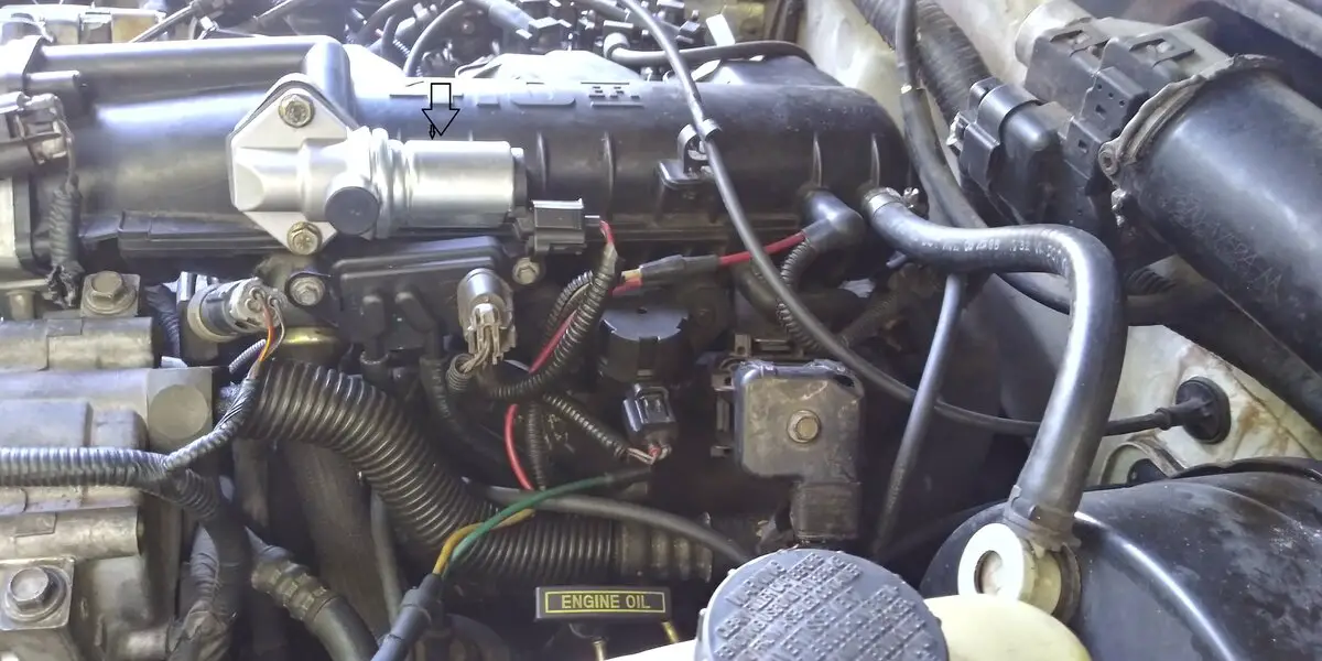

There is a rubber "Y" elbow that connects to the IAC valve, it's very common for it to have small crackes that can't be seen with the naked eye or a smoke machine. There's also a rubber hose that connects the PCV valve to an oil baffle. It too, is a common problem to start tearing and cracking on high mileage Explorers. Check out this thread.
this is my IAC direct bolt to the housing ..
PCV valve and hose are new
but thanks for that every answer is helpful !!
and mine is a 1998 4.0 ohv different set up than the guide you provided
but thanks again

i am going to take it apart again , i am going to order new fuel injectors and wait for them to come in before i do it , should be here fri

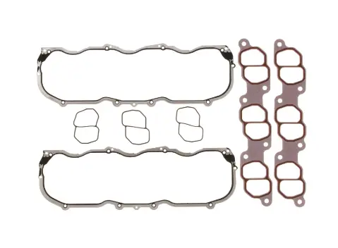

fuel pump was checked at the ford house 60 psi cold 65 hot so he said it was good , he was also saying that they recommend this see photo , i am going to change out the valve cover gaskets as well , the new set has a upper and lower gasket for the plenum as well as the plastic rings not pictured , and i have new injectors on the way so we will see

i just bought this set will get them tomorrow along with new fuel injectors , thanks for the reply

well this morning i finally got all my parts for the car i am going to install , new fuel injectors plus got the right gasket set this is the part number for the gasket set , its good at autozone and o reillys auto,
VS50209
plus just google the number and it will come up on several other sites
the part number for the fuel injectors is 0280155735 you should have no problem finding them . wish me luck i hope that this fixes the problem
i am so tired of getting the codes p0171 and p0174

your 98 has EGR you should really replace the large EGR O ring...... I am not sure if it is included in that Mahle set you have...
Fel Pro 71202
Ford part F67Z-9J469-AA
I use vaseline to help seat the O ring, so it does not pinch or crush

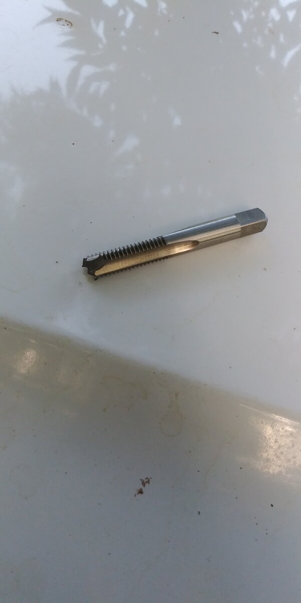

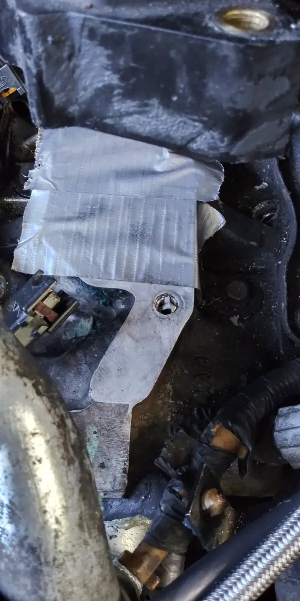

so still going threw hell with the car ,i got it all put back together on wed and it fired right up , but it was running rough so i waited til thr
to figure out what i did wrong , well i was checking my torque and discovered that the front stud was not tight at all ,so took it back apart
and got the plenum cover of started to remove the stud and the head snapped off . see photos so i could not get it out , i ended up filing
the sides to get a pair of vice grips on it and got it out , and in doing so i rounded out the stud hole , so went and got a rethreader and ill be damned 3 turns and it snapped off in the hole . the problem is that it snapped off with a point (see photo )and i can not get a bit in there to drill it out , i order some dewalt bits from amazon and just waiting for them to come . , in the meantime went down to walmart and bought a cheap set and can not make any progress with them a set of 10 i have all ready broken 5 of them and dulled out the rest of them . i was just lucky in away because monday i went to the junk yard and got an extra set of studs its the only ford they had was a 2000 so they did fit , so any one doing this job i suggest going to a junk yard and getting studs because i tried to find them online and they are a discounted item .
if i ever get this car fixed i am only going to use it as a back up , and now i need to go find another car i love my fords but this has just been hell !!
and still don't know if what i am doing is going to fix the codes . i do have extract tools but they wont work as long as the threader point is in there i need to drill it down flat if not i might just have to go and buy a new manifold .. any way wish me luck
