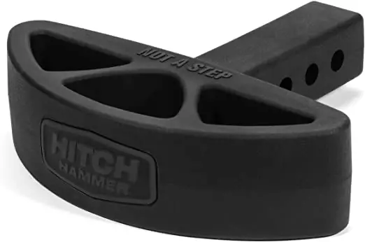

I installed this one. I bought it from Amazon its rubber.
