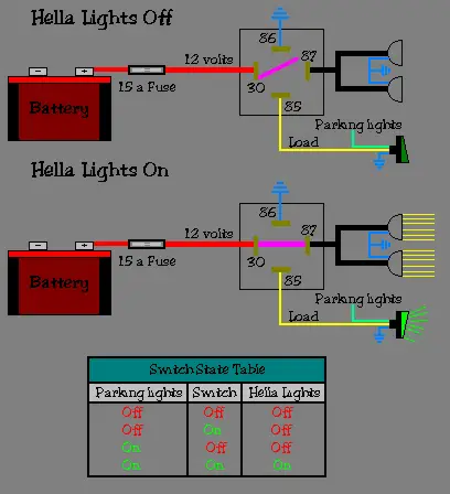

There are 2 power sources to be concerned with:
  • Low power @ the Switch to activate the relay.
  • High power @ the relay to power the lights.
For the switch I would recommend tapping into the parking light circuit. By taping into the Parking light circuit for the Switch's power you will have the benefit of the "Lights On" Warning Chime and lesson the chance of killing your battery by leaving the lights on.
The High power should come from the battery or "+" post on the starter solenoid mounted between the battery & Under hood fuse box.
See the Hella 500s thread for pictures and diagrams.

You could do either, but I wouldn't. It is generally not recommended to run HIGH power through the switch (and in the cabin). That is why any quality lighting kit will include a 12v relay to provide power to the lights. In the diagram below you would just omit the blue ground wire @ the switch if it isn't lighted.

DO NOT run the power wire from the battery directly to a dash switch BIG NO NO.
The wire coming from the battery should have a fuse, sized for the current in the circuit and placed in the circuit as close to the battery as possible, then it goes to pin 30 on the relay, from pin 87 to the lights. The dash switch is low current (approximately 1 amp) and will have only one wire coming from it to pin 85 or 86 on the relay.
The switch actuates the relay, the relay control the high current (approximately 30 amps).
Should I connect that directly to the battery or tap into the fuse box (or a wire coming from it)?
Depending on how U want the lights to work is how the wiring goes.
If you want the lights to work with the headlights then use the wiring as mentioned in the earlier posts but If you want the lights to work when you want them to you need to wire differently.
"How" you say... Take a probe and find a location on the Circuit Panel that has power only when the key is on; use that power for the switch power and run the other pin on the switch to pin 85 on the relay, that way the switch will only turn on when the key is in the on position.
If you want the lights to work with the headlights and with a separate manual switch then that will take more wiring and a different switch.
