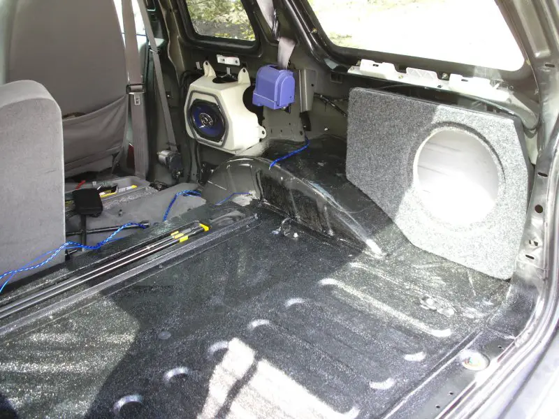

And here I did something.............
Finished Herculining the deck Thursday night.
Toady I reinstalled the driver's side interior and rear seat and started the install of the stealth box I got from Xan.
-Andy
