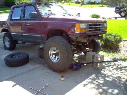

well I have everything where it needs to be. Drive shaft fits, coil buckets are in, radius arm mounts are in. Still need to do the trac bar mount and an adjustable trac bar and do the steering and then she will pretty much be done on the front. Here are some pics. Fisrt is final mockup of the suspension, and the second is the explorer sitting on on the tires.

Sweet! Good Job! I bet it is a little scary with no Trac bar! Hows your driveshaft to Y pipe and Diff to crossmember clearance?
Your tellin me i thought the damn thing was going to fall over getting the jackstands out. I havent checked the crossmember clearence yet. Ran out of time. it looks pretty close. may need to stepup to the coils your have. Your wana do me a favor kirby? after i get a track bar on there, you think i could test fit one of your 37's? I'll pay ya. I'm trying to keep it as low as i can and run 37's.

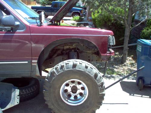

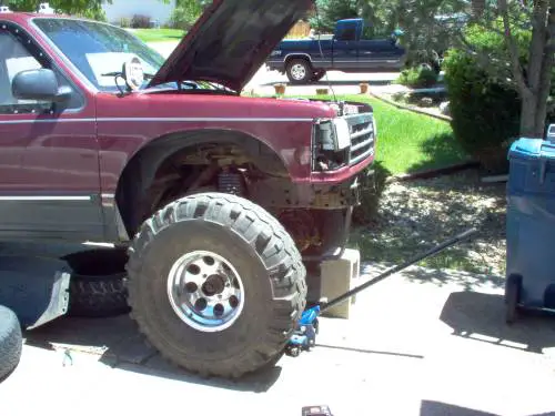

well here is the first test fit of a 38x12.50. Need to make some room for this thing. If I can make this fit then 37's shouldnt be a problem. I'm at about 6 inches of lift right now. After i put in my new coil seat i should be at about 7 inches. Dont really wana go any taller. So i need to start chopping up the fenders.

here is the fender after some triming. Still have a few more things to do but looks like they will fit.
