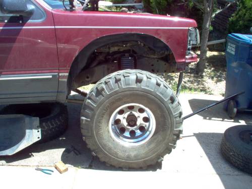

Gotta love the first fit of the big ol tires, thats when you see it all come together!

here is the fender all done. Now i have plenty of room. what a difference a 38 is compared to the bald P235x75r15. Looks alot better with the bigger tire on there. Its finally starting to come together. Now i need to decide if i want to run 38's or 37's

What did you use to trim the fender?

Positive Vibes said:What did you use to trim the fender?
an air body saw. I like it i have used this thing so many times. its worth the money. I think i'm goin 38's cause i think they look damn good and plus now they fit.

I say 40s.Joe93 said:Now i need to decide if i want to run 38's or 37's or maybe some 40s

Thats why you cut it high enough that the tire is an inch away from it at full stuff.Nick26 said:is the edge of the fender sharp now though? wouldn't want the tire to hit at full stuff, i imagine itd slice right into it?

Kirby N. said:Holy Sawzalll
I knew i could make them fit. Yeah the edge is sharp. I'll fix it if it becomes a problem. I was trying to go with the least amount of lift and the largest tire i could.

Trckmagik said:Looks good Joe. You can fix the sharp edge by using Door trim guard. You can find this in rolls at your local Auto Zone for a couple bucks.
thats a good idea i'll look into that thanks
