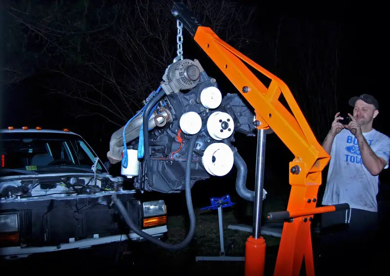

Yea you had way less room than i did!! It would have gone in with the convertor but just couldnt see or feel like fighting it! Damn low ass truck!! Mine was SOOOOOOO much easyer!!! You wanna see room Brandon wait till you see my truck! You coming to the NC trip right?
i have plans for the being low part, but this task had to come first.
eh, yours is getting kinda cluttered, but i do have less room still

edit: worst its even been! washed my hair 3 times to get the water clear!

Yea i had to use two soap bars to get clean!!! My head is swollen and black and blue.i got cuts and missing pieces of skins every where!!!hahah like the pic of me covered in oil wearing my BUILT FORD TOUGH shirt in the first pic!!hahaha

lol i brought some orange cleaner with me, helped a lot.
yea im missing a couple chunks too. that shirt was nice until 5.30 lol
my trucks too damn low, i can see your whole taillight in my back glass lol
and that damn red gasket crap you put on, ick :/
Haha yea just noticed that too!!your camera make that gasket crap stick out like a sore thumb,should have bought black!!
well i did some editing. i shouldve lowered the vibrance of the reds so itd be less noticeable lol

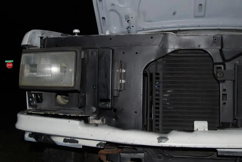

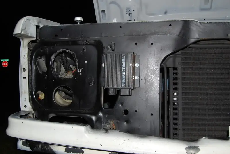

didnt get much done due to going to dinner and it being dark after. all i did was find a mounting spot for the fan controller
