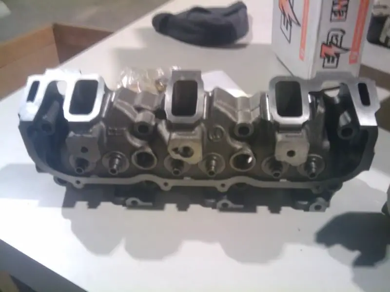

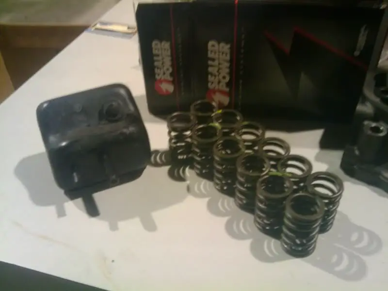

new heads. everything look ok? got the springs and 1 motor mount also
Take a flashlight and shine it down the three hole where the rockers mount and look into the ports and see if you see any light.the the flaw i had the hole was drilled to deep and went into the intake,not a big problem as you can thread seal the bolt,just happens when you get big ports.besides that they look great!! Yake a pic of the exhaust ports for me i wanna see how much of the humps and stuff they get ride of on the 93 tms.bet your getn excited now!!
The intake ports,you shouldnt be able to see light.

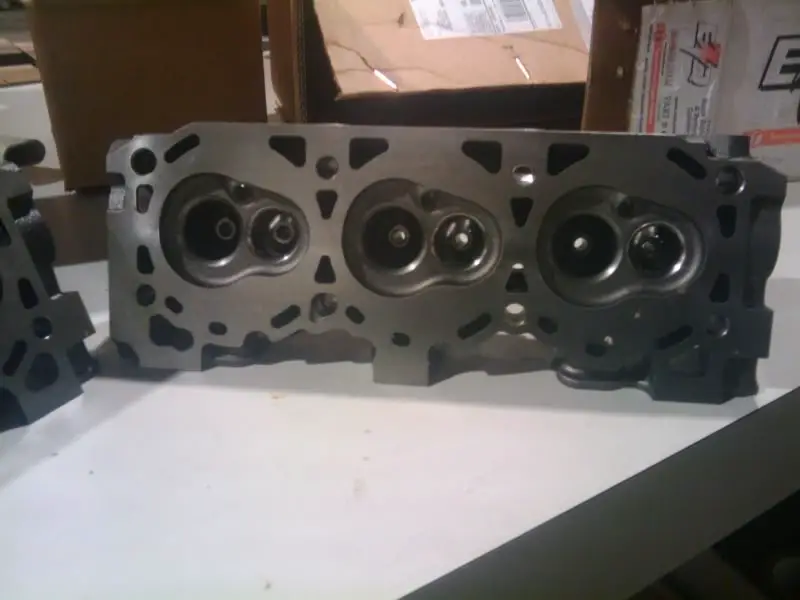

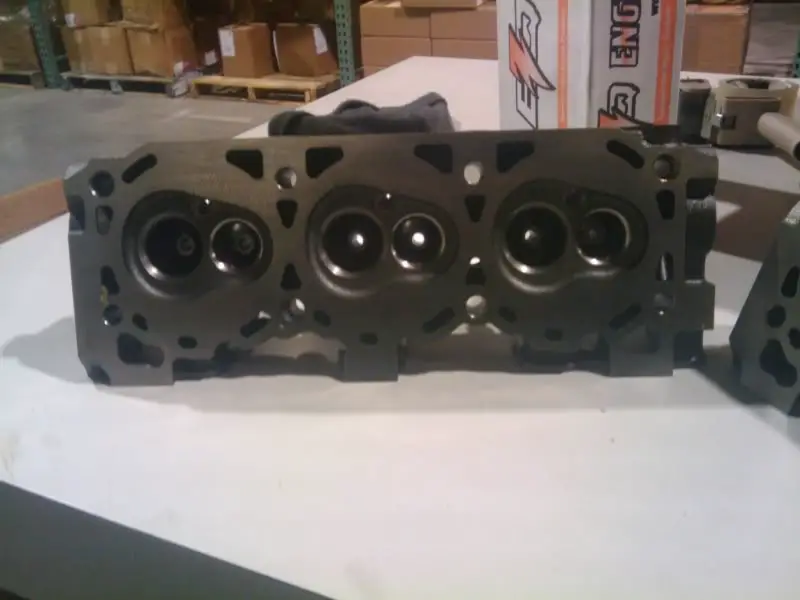

ill see if i can get a flashlight somewhere and look. heres the exhaust ports tho
Then your good to go! Thats all easy 5min stuff.if you had valves we could set the heads up.you need to get a lift and i dont really know anybody

O yea heads are good to go.i wouldnt do anything to them plus they flow better than stock to begine with!those fuel lines can be tricky if you have delt with them before

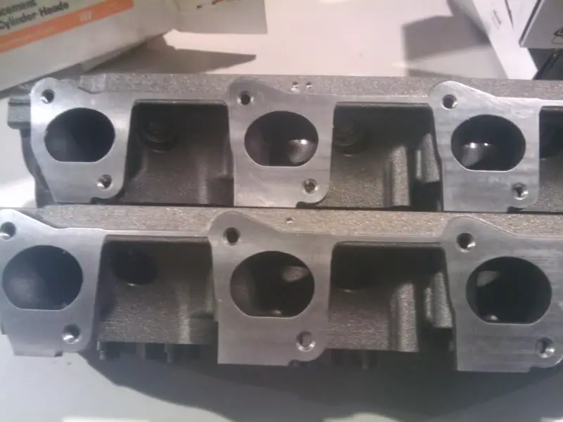

yea i guess they are quite large.. re-looked at yours and mine look a little bigger, and you had yours taken to a shop to make em that big right?
paperwork says 60cc.
edit: trying to order the valves, no one answered the phone :/
Nah mine are somewhere around 46-47cc, stock they were 48cc. Your stock 90-93tm's are 60cc. I was just messing with yah :p:
