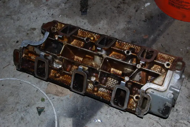

its been cleaned some. it was worse

something i just thought of.. i dont rememer any vac line being attached to the fpr. its the round thing on the fuel rail with the fuel line attached right? i saw something where bad mailage was related to the line being off. i got 11-12mpg and they were saying 8-9mpg, but still
This was for my 2nd Gen OHV; The FPR had the main feed which was the braided fuel line going to the top, then the nipple with the rubber o-ring going into the fuel rail, then on left of the FPR was a vacuum connection leading back towards the firewall where the vacuum tree hooked up to it.
P.S. - If you've got a power washer it will greatly help you with the bottom of that lower intake, getting your hand in there and cleaning each of those ports on the bottom of it will SUCKS!!!
that piece to the next next to the injector is the vac line right? that picture was before i even touched that stuff and i dont see a line for it. all but one stub on the vac tree had lines of it(which is correct i think) so it mustve fallen off the fpr. heh, alteast its getting corrected now anyway
no i dont have a power washer, ill prob try the car wash on a nice day. the top of the lower intake came out good, but the bottom didnt
