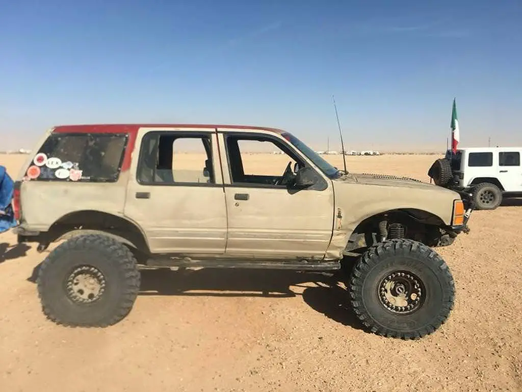

well the weekend was great to get back out in the desert. Left Friday, got back Sunday. I have no idea how many miles I put on the truck, but i did go through over a tank a fuel, which i haven't done in a very, very long time, if ever in this truck. The one thing about the truck that is most evident... I really need to fix the exhaust. With the new roof and lack of sound deadening, it is extremely loud and sounds terrible. This will most definitely be my next focus. Other than the loud, it needs a tune up, and the power steering pump pulley is out almost a rib, which ended up shredding a belt and ripped one of the ribs off the replacement belt early on Friday. After pealing the outside rib, the belt aligned itself and was fine the rest of the weekend. I didn't get a lot of pics this time as i was just glad to be out there, but here are the ones my buddies got of me from their vehicles.
The pretty side of the truck hanging out at camp

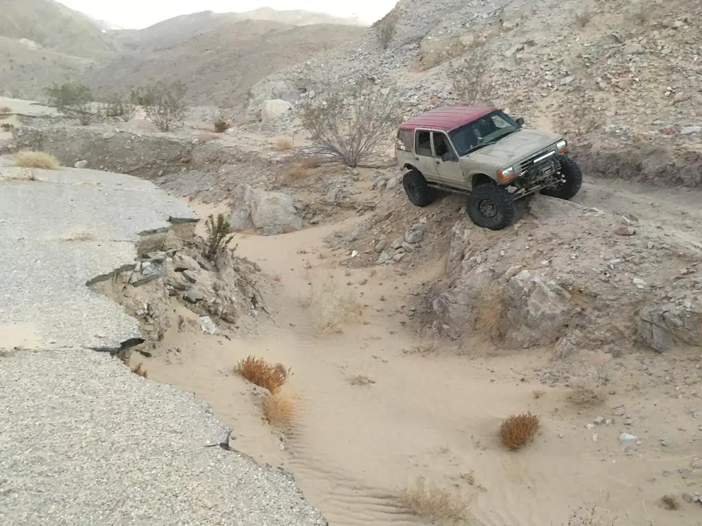

THen I was on my way back to camp following the pole line road (a totally different one than I thought) and the road decided to disappear. We were on our way to the part you can see when the truck slid off the trail, and we proceeded to wait 2 hours for help as I didn't have anything to run the winch to.
The ledge it is sitting on is about 6 feet tall, and the truck kept sliding every time i would try moving it, so we gave up and called for help. Thankful to my buddies who decided to go on the search for us as we were lost.

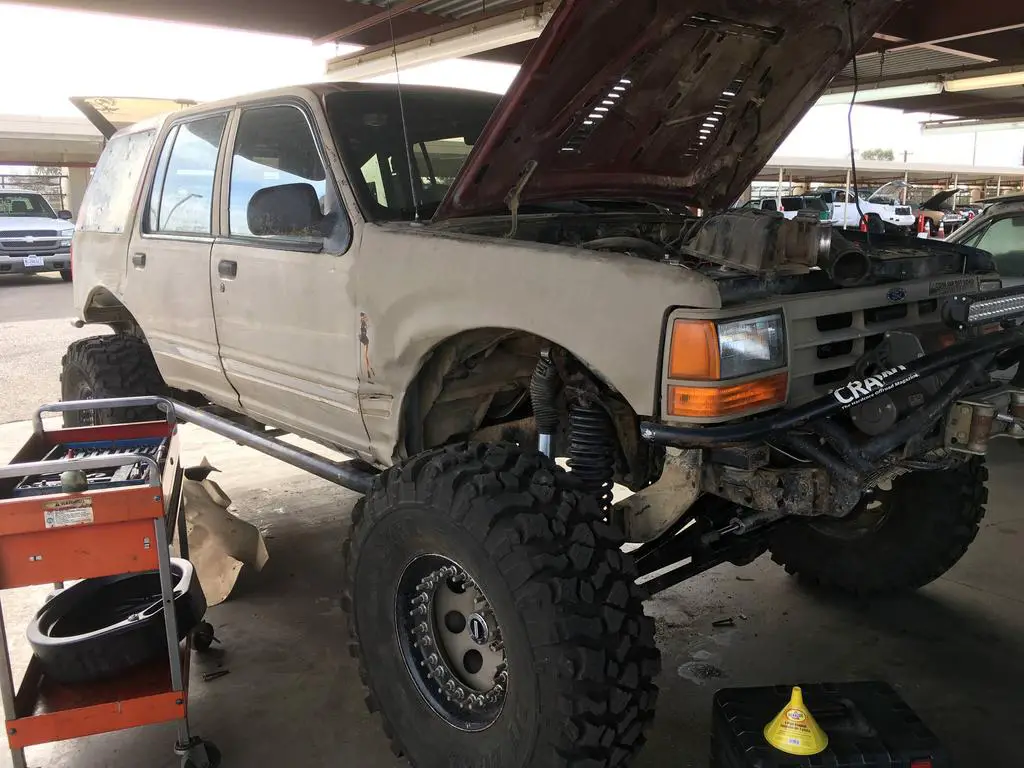

I took the explorer up to Miramar this weekend to finally address the exhaust leaks. I knew it was going to be a major pain in the ass, which is why I waited so long. I couldn't handle the leaks anymore, and I already had the majority of the parts, so I went for it.
I ended up using a used pair of exhaust manifolds from a friend's spare motor that has always been in California. The manifolds and the y pipe were in great shape, but the bolts were not so good. after a significant amount of heat from a "propane" torch, I was able to get all the factory bolts from both engines, without breaking a single one. They were extremely deformed once they were out, so I didn't even hesitate to pick up some new 10.9 strength metric bolts for everything.
The old cats were in really bad shape. I believe the front one was clogged, based on how heavy they were.I didn't even try to break the y pipe bolts loose from the manifolds, i just hacked the y pipe out and threw them in the scrap pile.
I picked up a factory replacement cat off ebay, and it was complete ****. There was no flange for the ball and socket portion, the flange that bolts to the y-pipe was too small, so I had to cut it all off, and reform it to fit, and it had a bend in it that the factory setup did not. If I hadn't bought it so long ago, I would have sent it back. I do not recommend people buying the ones from Canada off Ebay. Just suck it up and buy the magnaflow ones.
With the free-flowing cats, new y pipe, non-leaky manifolds, new bolts, new gaskets, and new 02 sensor, the truck runs great. It is still really loud due to the less restriction, but its nothing a muffler won't fix. Still hoping to get to Corral Canyon this weekend. If so, I'll post up some pictures and a review on how the day went.

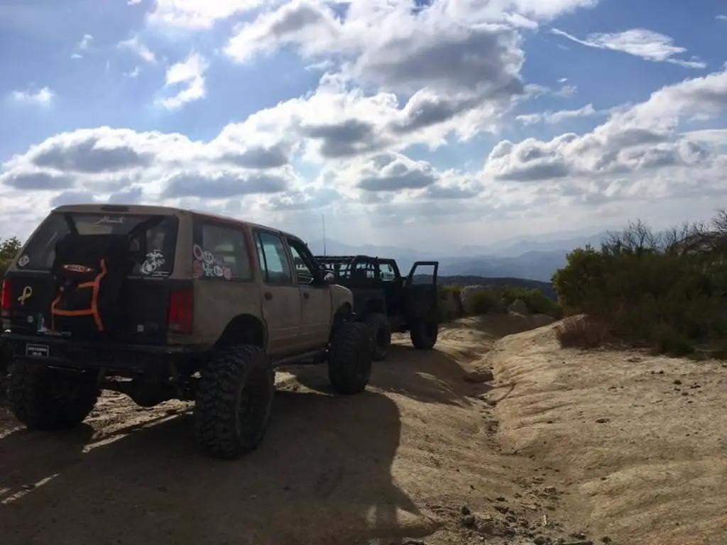

At the top of the peak, it was pretty breezy, and temps were in the mid 50s by this point in the day, and we had all the tougher obstacles coming up, so we didn't stay around long. Also, you can see my awesome new Maxxis Tire trasharoo bag that was gift from a close friend.

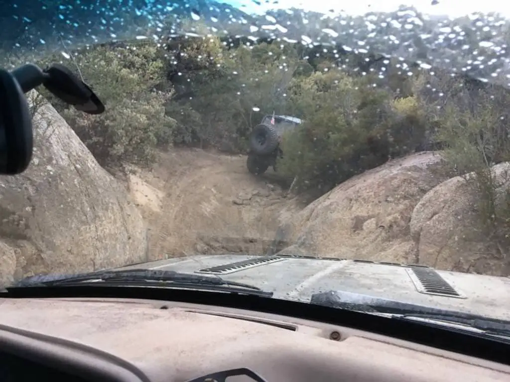

Julie, the driver of the JK was leading as I completely forgot where all the entrance and exits to all these trails are, so she hit the rock garden first, and got REALLY tipy by trying to get around a rock. She even pulled the back tires off the ground once, so that's when we called it and used my winch to pull her back so she could get a better line, then she drove out the rest of the way.
