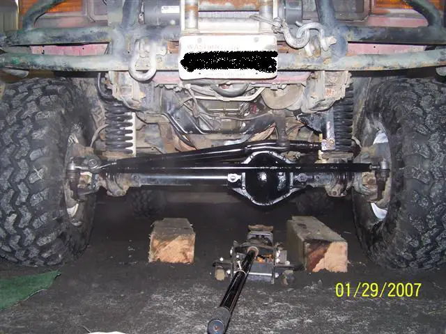

Tie rod over knuckle complete

Whoa, when did you get the shop built???
More pics
looks good....I might have to use this setup now....Impressed..

are those the stock radius arms or did you buy the longer ones
did you have to buy longer brake lines or shocks and how much did it cost just for the front axle swap cause im getting ready to do the same to mine
The brakelines are 6" extended if I remember right, the radius arms are stock witha slight bend in them for tire clearance.
You can swap in a axle fairly cheap if you find donor rig, it is the upgrades that start costing you money, I would guess I have around 3K invested in my front axle as of today
