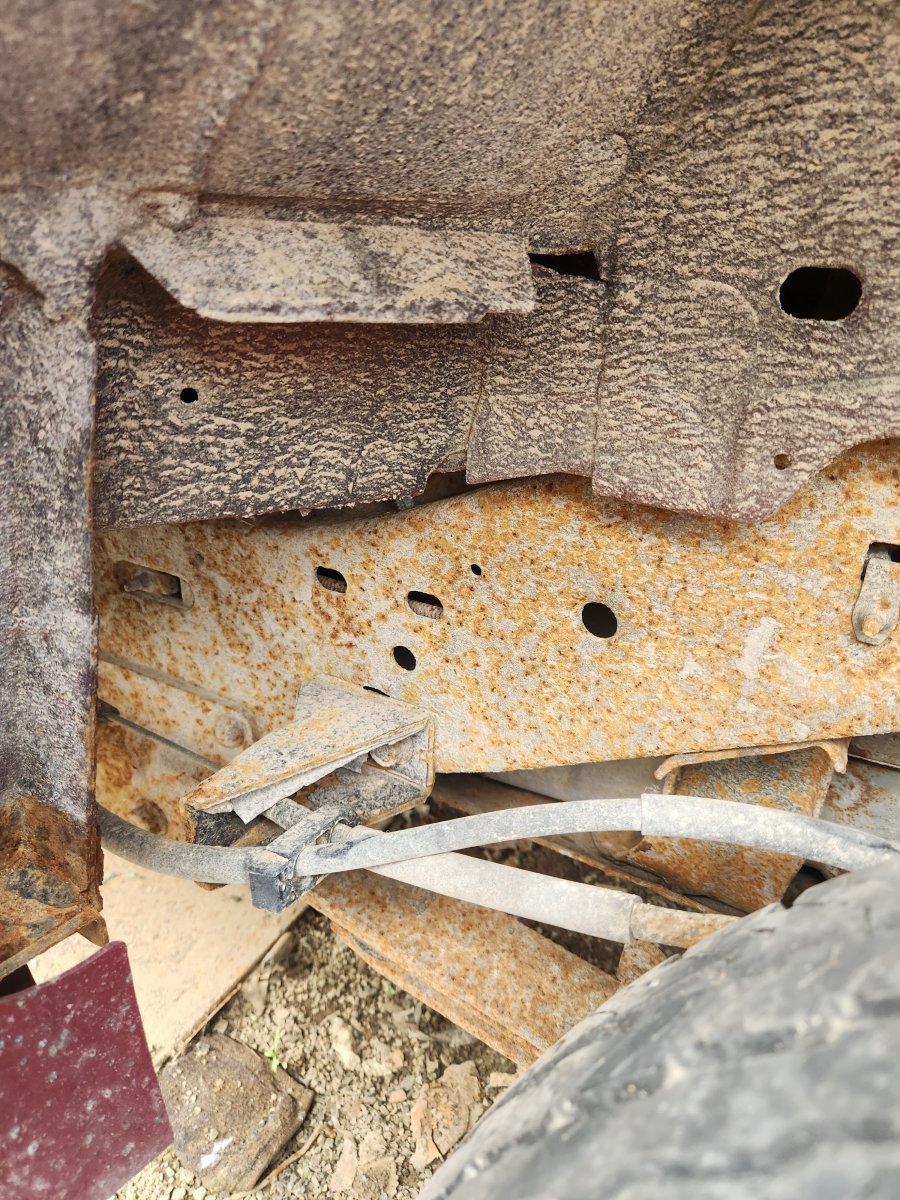

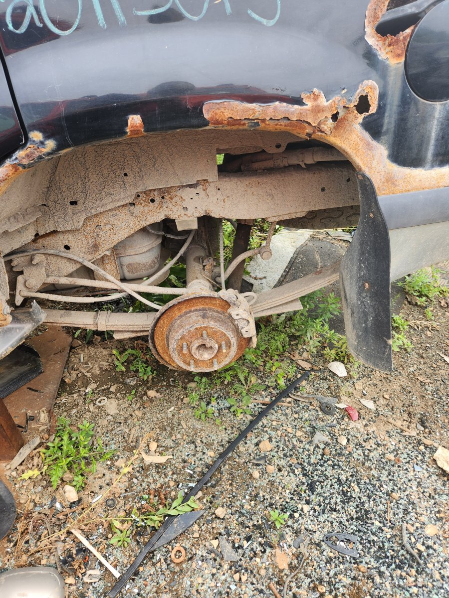

Moving on.... I've been doing some of my own junkyard investigating on some of the differences between the 4.0 and 5.0 trucks (its convenient when they are both right beside each other). The main thing I'm noticing is the differences in the rear end. My dilemma is whether or not I should buy the rear end and leaf springs out of a 5.0 truck. He are a few photos of the obvious differences that I'm noticing between trucks.
This is a 98 5.0 truck, and as you can see, it has some sort of traction device and 4 leaf springs.
This, on the other hand, is a 4.0 truck, and it has no traction device and 5 leaf springs. However, the frame seems to have the provisions for the trac bar but not the differential housing.
I'm assuming 1 is for performance and lower profile and the other for towing and ruggedness. What's you guys take on this? I'm uncertain on if I want the lower ride height or not with the 5.0 springs. Do these trucks wheel hop bad enough that they need the traction bar? I suppose I wouldn't have to change rear ends. Just weld my own trac bar mounts on the axle housing? Opinions?
It’s not about ride height, it’s to help prevent axle wrap. All 5.0s have them.

as for the axle, 4L and 5L are the same with the exception a 5L will have a trac lock in it where a 4L might. also a 5L will more then likely have 3.73 gears, 4L is a guess as to what it will have.

The junkyard truck has a d4 code for 373 posi when I go to pull my truck out of storage I'll have to look at what my door tag says. I think If my truck has anything worse than that I'll be pulling the front and rear diffs if not I'll just weld tabs on my housing for the traction bars. Still not sure what springs would work best, although I'll likely buy those new if possible I don't have it in me to want to deal with bolts seized to bushings in the junkyard. I'd like this truck to have some off road capability I'm not concerned at all with performance. If that makes a difference.

I'm pretty sure the rear control arms, traction bars, are indicator of V8 with 373 limited slip.
Some V8 did not have them. Most did however.
If reliability is goal, for your swap get an engine matching donor vehicle so you have good wiring and pcm. Go for 99-01, and keep everything stock.
