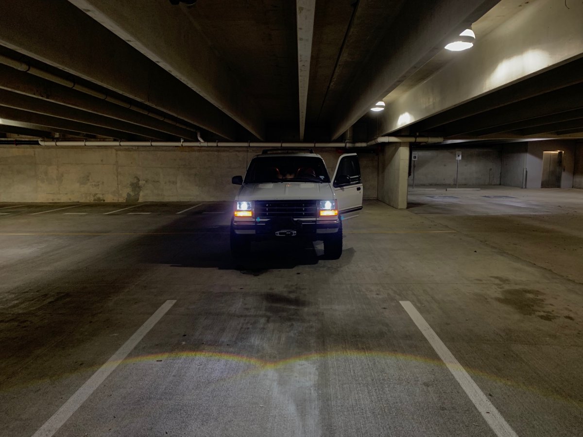

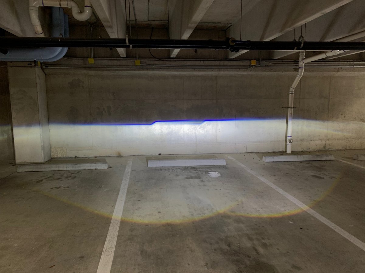

I don't have a build thread. Partially because I wanted to make sure they were going to last before promoting them. They've held up really well so far. The process, like any retrofit, involves removing the lenses to install the HIDs. I had a set a of clear lenses laying around and that makes the lines very crisp. If you were to re-use the rippled lenses the sharpness becomes muted but usable.
Rippled:
Clear:
Wiring them up may take some effort though. I bought the 9007 light connector kit off of ebay and made my own harness to connect them. The high beams are just a relay for the lid to open and close. That means you need to supply power to both the relay and the light from the high beam power. A few schottky diodes on the 12v power and the high beam 12v worked fine.
