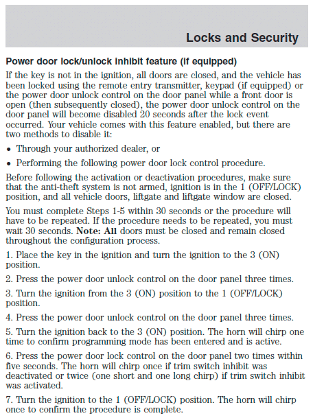

It looks like from searching posts there is a sequence of turning the key on/off that somehow can possibly re-sync some sort of signal, I could not confirm if this is the case with the 2010

thanks for the link,

OK, i went through the sequence.
The car locked/unlocked after turning the key on/off 8 times indicating it was in program mode
when i pushed the key fob button it locked/unlocked indicating it had reprogrammed
after exiting the 'program mode' it still does not work
I have yet to check it on one of the testers as suggested but will do that when i stop by the parts store, i assume since it communicated when i pushed the button it does transmit
any other thoughts?
Ornery,
that is the sequence that i followed initially, (and now a second time - see below) thanks.
