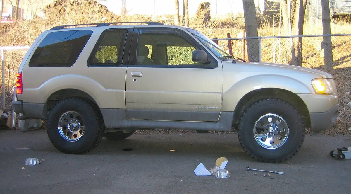

Purchased these a week ago decided to see what *I* needed to do to get them to fit. Looks to me I don't really need to do anything but I was looking for a Off-Road look and to me that goal did not get accomplished. Maybe lifting the truck 2 inches might help. Also stock my truck came with 16" wheels, the wheels purchased are 15". There is not enough clearance between the rim and the caliper to even clear the stick on wheel weights. There around .125 clearance.
At full lock the inner tire just rubs the swaybar.
Maybe 33 x 10.5 would be perfect
