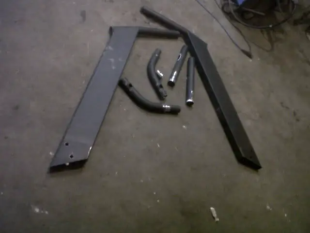

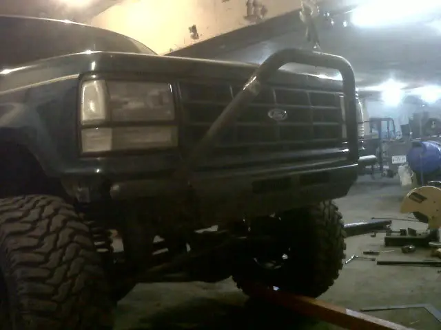

Then I saw the broken treadmill lying outside on the ground and decided to add some "temporary" tube to my now chopped front bumper...
From this
To this
To this
Not much for super strength or functionality, but it looks pretty good IMHO. It's 2" x .080 wall tube. It's just temporary unitl I get my real bumper built...which could be a while.
