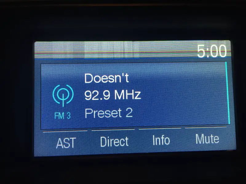

Hello everyone. Been a member for a few weeks now. Everyone has been very helpful. I have a 2014 PIU. l have had it for about 2 months now. I have noticed the display is slowly working its way down. When I bought the PIU maybe 2 lines were noticeable. Any ideals how to stop it?

I believe that you are referring to the APIM.
