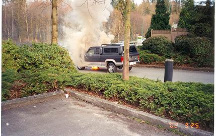

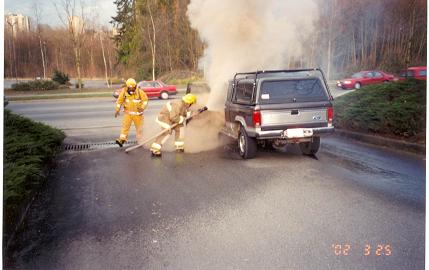

Guy at work`s truck burnt down a while ago, broke his heart, and he had no way to put it out. he was driving home when he smelled gas and pulled into a parking lot just as gas started burning in his engine compartment
Makes ya think. :(
Of course, by the time some of our finest reached the scene, the truck was a write-off.

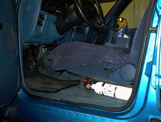

I immediately added this to the Ex, which should be part of your trail kit anyway:
