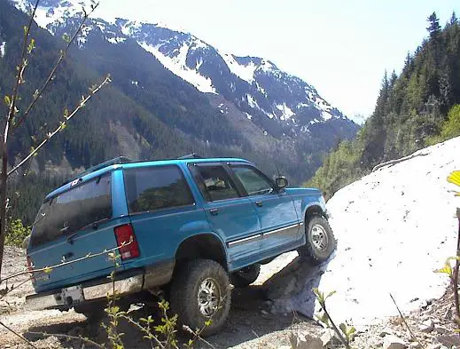

That`s my boy hangin` out the window. He was scared at first and then wanted to 4x4 all day long! The truck looks clean because we just ran through all the water at the base of the falls. In some places you could reach out your hand into water like that.
Shortly after that shot, I got into a trail and got some nice tree branch scratches from it. Tom said he didn`t think I would want to do it, but I figured that this is why I`m building this up, so I might as well get it over with.
It`s gunna hurt when I wash it tomorrow tho`
We had a great time checking out all the side roads and no one got stuck. The second day I followed Tom into this path he found and gave up after getting more scratches and bending my side skirts up a bit. Tom broke off his side mirror and a fender flare when he pushed on. I waited on the road for him and felt sorrow for the "cosmetic" damage he got.

Here`s 1 more pic I thought was cool:

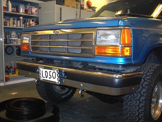

My plan is to replace those bumpers one day, but to make it acceptable for now, I started with the front:
Can`t remember where I heard this, but I went and bought some lawn edging and trimmed it to about 3 inches in width, and fit it in the gap.
I trimmed some off first:
I drilled 2 holes through the old gap fill trim and fastened it with 2 machine screws and nuts, one close to the tire and the other about 4" towards the front.
Then I pulled it tight to the other side and held it with vice grips to drill the holes and put 2 more machine screws in.

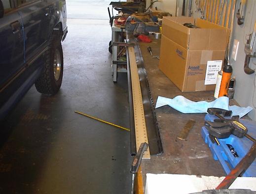

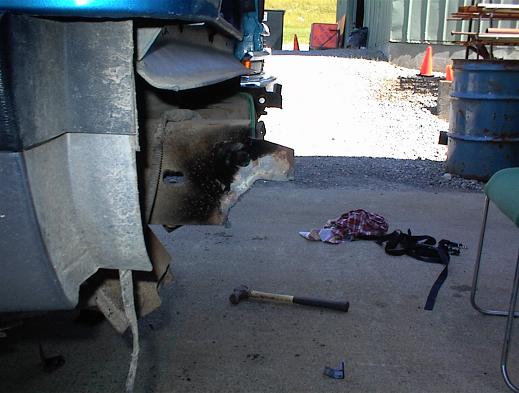

Remounting rear bumper after 2" body lift.
Well this turned out well. It took me three hours, but If I had these instructions it would have taken me two.
Tools I needed:
-Acetylene cutting torch
-Welder
-Socket set (obviously)
-Stationary grinding wheel
-Hand grider
-Hand buffer
-Big drill
I was lucky to have a shop at my disposal, but I bet if you didn`t have this stuff, or the know-how, you could roll into a shop with your bumper off and get this done cheap.
I started out by taking the bumper off, and then decided what to do.
I measured straight up 2" from the lower bumper hole and chalked a circle.
I then chalked a line for my cut that would allow the bottom lip of the bumper to have room:
