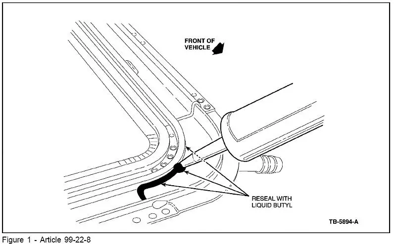

TSB 99-22-8
WATER LEAK—WATER LEAKS INTO VEHICLE Article No.99-22-8
AROUND MOONROOF
FORD: 1998-1999 EXPLORER
MERCURY: 1998-1999 MOUNTAINEER
ISSUE: Water may leak into the vehicle through the the
moonroof opening on some vehicles. This may be caused by a sealing concern at the front moonroof drain.
ACTION: Reseal the area as required. The sealant should
prevent water from entering the vehicle through the
moonroof. Refer to the following Service Procedure
for details.
Service Procedure:
1. Cycle the moonroof to the full open position and remove the headliner trim ring around the moonroof opening.
2.Remove the overhead console, the moonroof motor, and the air deflector as outlined in the workshop manual.
Note !: It is important not to move the gear on the motor or move the glass panel. The motor must be reinstalled in the same position from which it was removed.
3.The two front gray drain corners have two seams that are located in the water channel and another seam along the inside radius of the drain corner (Figure 1). Apply waterproof Liquid Butyl Sealer (F8AZ-19554-CA) to these seams on top of the present sealer. Ensure that the sealer is flattened so that water can run into the drain hoses.
4. When the sealer has set up, pour water into the channel to check the seal. Ensure that water does not spill over the water channel or a leak will occur.
5. Look between the headliner and the moonroofto check the underside of the seam for a leak.
6. If no water leaks occur, reinstallthe air deflector, moonroof motor and the headliner trim ring as outlined in the service manual.
Scucci
