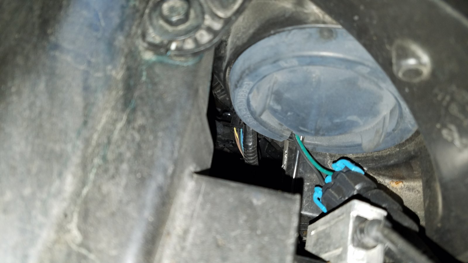

For those asking for pictures of how the LEDs were installed, here's how we did it on my Ex. we cut a notch in the outer ring of the dust cover to allow the wiring to go through, but that also keeps the dust cap in functional order. Then we simply zip tied the ballast up. We could have cleaned the set up of the ballast up a bit better, but since it's not currently a show car I didn't figure there was much of a need (can always fix it later with a couple of screws.)
Anyway, I hope this helps.

Thanks for the pics - they are very helpful. And since I can't remember anything even from yesterday, what type of LEDs did you put in? I'm too lazy to look it up! Do they have the fan thingy or a heat sink? Thanks....
They have the fan. The same ones that @Fentress24 used on his. No issues with putting the dust cap back on (hitting the fan, I mean.) I probably could have got the ballast into the light opening if I had the patience, but it was a tight fit for my hands and this seemed like a much easier solution. Not overly concerned about overheating as most of the time I use the low beams, anyway.
