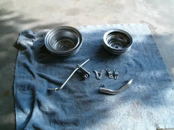

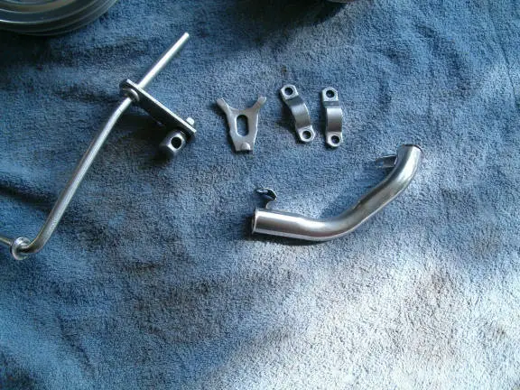

I took these in yesterday. Full gloss chrome hybrid
Still have the fan to do-it is painted with some hell that my blaster will not cut off:mad: .

Nice work... :thumbsup:
