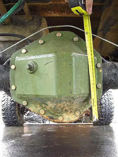

Weep from above the angels doeseth -- which means its pretty wet outside and I couldn't get a good picture/measurement w/o laying down on the driveway (with the naked worms!
But the 14b's vertical cross section is about twelve and a half inches and the centerline of the axle is about six and a half inches from the bottom of the differential

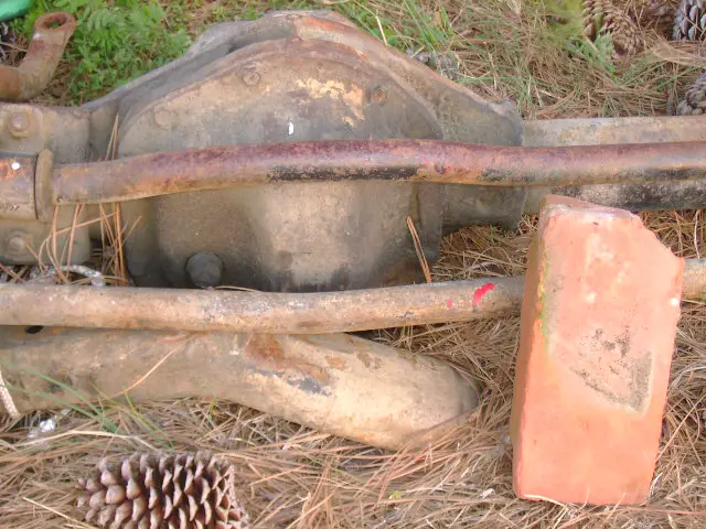

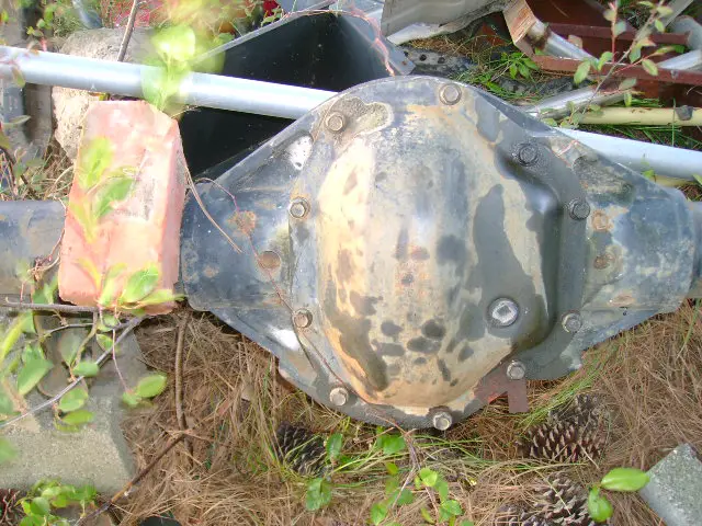

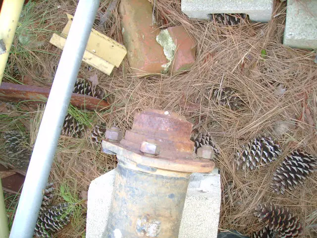

THanks IZ that is perfect. I just remeasured the 80 It is around 6.75" from the axle center to the bottom of the axle. I'm concidering shaving it and building or reworking the stock cover. This should be able to be done with little or no funds so I can work it untill i get all of the peaces purchased. Also I think all I can narrow it is to 66" wms to wms because of axle tube taper. I will get some pics up this weakend and some of the carnage. The guy that owned it said the tire ran off in a ditch and the spindle snapped. I'm guessing due to the locker engaging and the wheel stopping instantly at that rate of speed:eek: maybe. Posibly more due to a flawed spindle. Again thanks for the info.

Here are some pics d44 vs d80.[/ATTACH][/ATTACH][/ATTACH]
