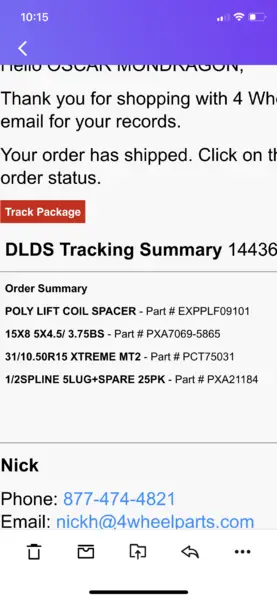

This is what I bought. The sales rep said this was all I needed
COIL SPACER!!!!!!!!!!!!!!!!!!!!!!!!!!!!!!!!!!!!!!!!!!!!!!
Your truck does not have coils......it uses torsion bars
"The Rep" from 4wheelparts sold you the wrong stuff and deserves a lesson in Fords......
Here is the part number you bought for $103
https://www.4wheelparts.com/p/pro-comp-2-inch-leveling-lift-kit-plf09101/_/R-DFCW-PLF09101
Those are coil spring spacers for a JEEP and this is only a front lift
I would cancel that order and just get some shackles for the back, lots of info about good shackles to use here on the explorer forum (EF)
For the front use the search bar here on EF and search "torsion twist"
