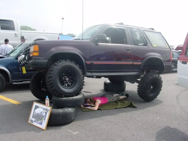

I know this is a old thread but heres a pic of my truck when it was stock 32" Dunlop Mud Rovers

That's kinda of amazing to me... I can't imagine getting these tires on my rig when it was stock! I guess if you keep them on a 15x7 wheel that helps but with my setup I think if the tires were any wider I'd be rubbing the front sway bar.
Any pics of your truck? I'm interested to see what it looks like.

yes those are 32x11.5x15's,,,and yes there was a little rubbing..had to do some trimming behind the wheel and rubbed on the swaybar not too much

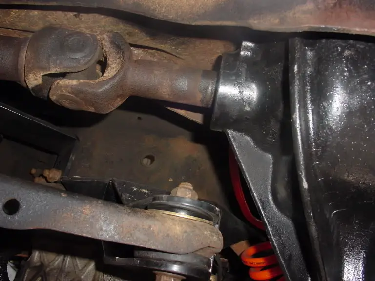

Never heard anything about the superlift and the diff.
Mine today... STUFFED
No way will the diff hit the drop bracket.
