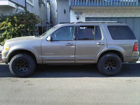

Before and after
Yup the rear end sure sags now. Depending on where I park it doesnt look like it sags that much all the time. I plan on ordering 1 1/2" springs for the rear now but first I'm going to try the spring lox to help level it out. It'll look pretty sweet when the rear is up more. Oh yeah and I took the running boards off.
Got my clear corners in today, get my flowmaster 50 series cat back on Friday, and I hope to get some smoked tail lights :D . I have a LoadWarrior cargo basket to put on too.
* I updated the second pic. I put those rubber spacers in the back until I get the permanent thing. It looks and drives great. You cant really see it but theres my new SS tip cuz I just got my 50 series put on. Sounds like it looks now!

now im kinda wishing i still had my 3rd gen =/
that bodystyle looks bad ass with some hight and bigger meats
It looks way better than stock thats for sure. Why did you get rid of your 3rd gen?
Yikes! That is sweet! Man, you weren't kiddin' at all! You're going to keep it level when you add the rear springs, right?
Very very nice, it looks great up front, cant wait to see it with the rear end up too.
I can't wait to get the rear up. It does look nice and the younger crowd seems to like it with the front end up and I do too but not this much. I wanna do about an inch and a half in the rear.
Very nice! I also like the rims are they steel and who makes em?
They're alloys. Pro Comp 8069's. I originally put them on with the chrome center cap and it just didnt do it for me. I like how they look thick in the holes as opposed to the steels.
