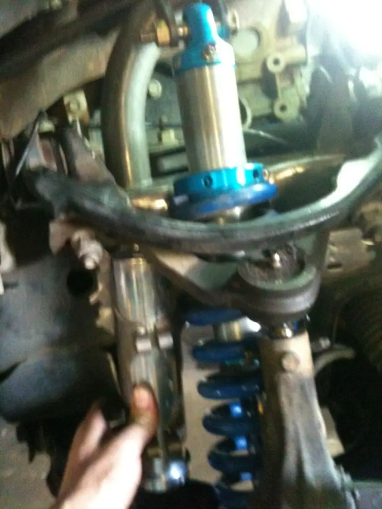

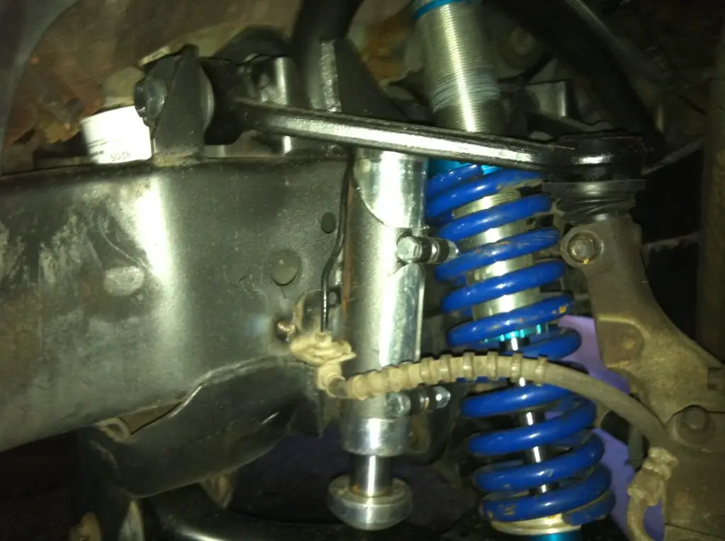

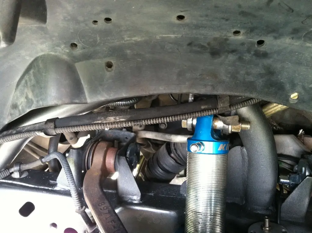

ok guys a little bit of an update, passenger side is done. i got some pics for yall.
this is with the adjustable uca which wouldnt work with my bump stop sooooooo.....

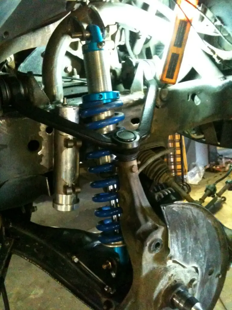

i changed it out with a driver side uca which works much much better. this is at full droop....
so far with stock uca's im pulling about 3" more of downtravel but an extraordinary amount of up travel. i will have to rebuild the bumps as they are foa and i bought them off of the DR forums and they look somewhat used but it shouldnt be too bad. I'll also have to strap it since its a 6" and not an 8". plus have to pick up taller springs since the spring is atleast 2" shorter than i need.... so a 14" will have to do. havent crunched the exact travel numbers since the driver side needs to be done. I'm kinda on the fence about how the hoops look but as long as its not bottoming out im fine and plus the pictures were sent via phone so in person i may like it a lot more... let me know what you guys think so far.

so far with stock uca's im pulling about 3" more of downtravel but an extraordinary amount of up travel...
The extra "up" travel comes from the higher upper shock mount on the hoop, i'm guessing, but how does it give you more droop? Or is the extra droop only on the right, from going to a 1-pc uca?

More or less it's the lower ball joint being replaced with a Johnny joint. That made a huge difference as they can go to steeper angles compared to a ball joint. Dont get me wrong the uca is a limitation to more travel but there still is a bit more droop you can get out of those puppies appearantly. There are quite a bit of factors involved but many of them have been figured out and to where we can get a substantial amount of travel out of the suspension without going to long travel. Go check out the previous pics I posted of the build and you will see what angle we set those cups for the Johnny joint.

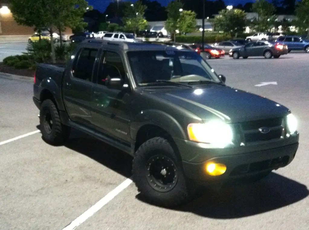

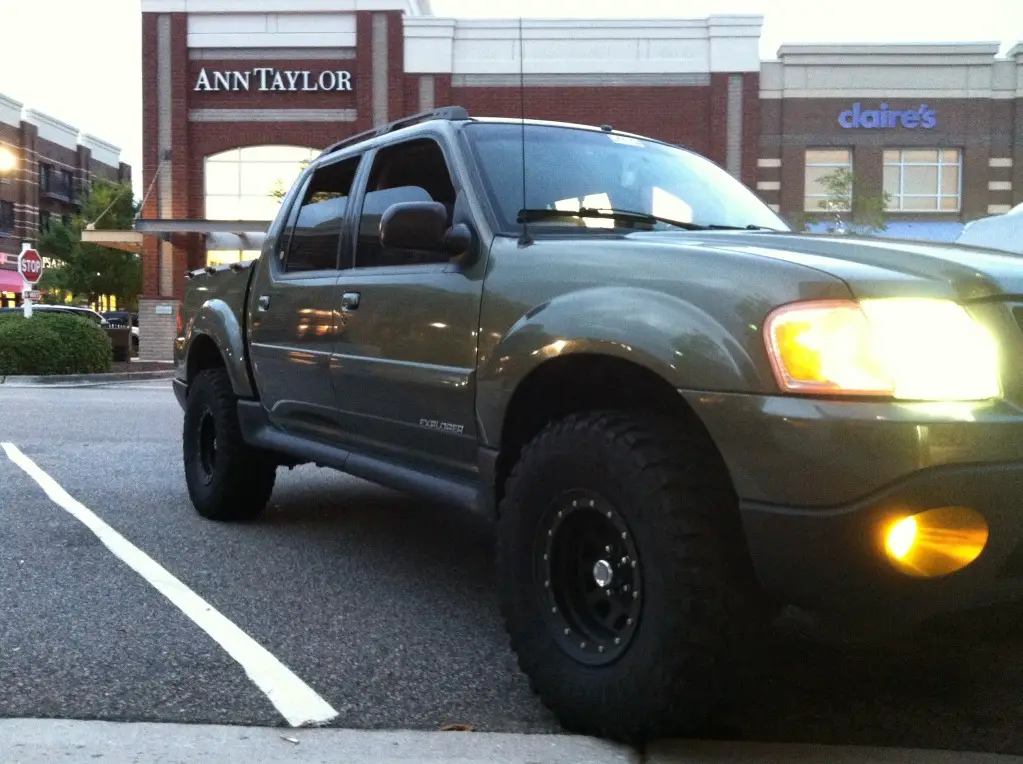

here ya go guys: here ya go guys, i had some more pics i took while we were at the shop finishing everything up....

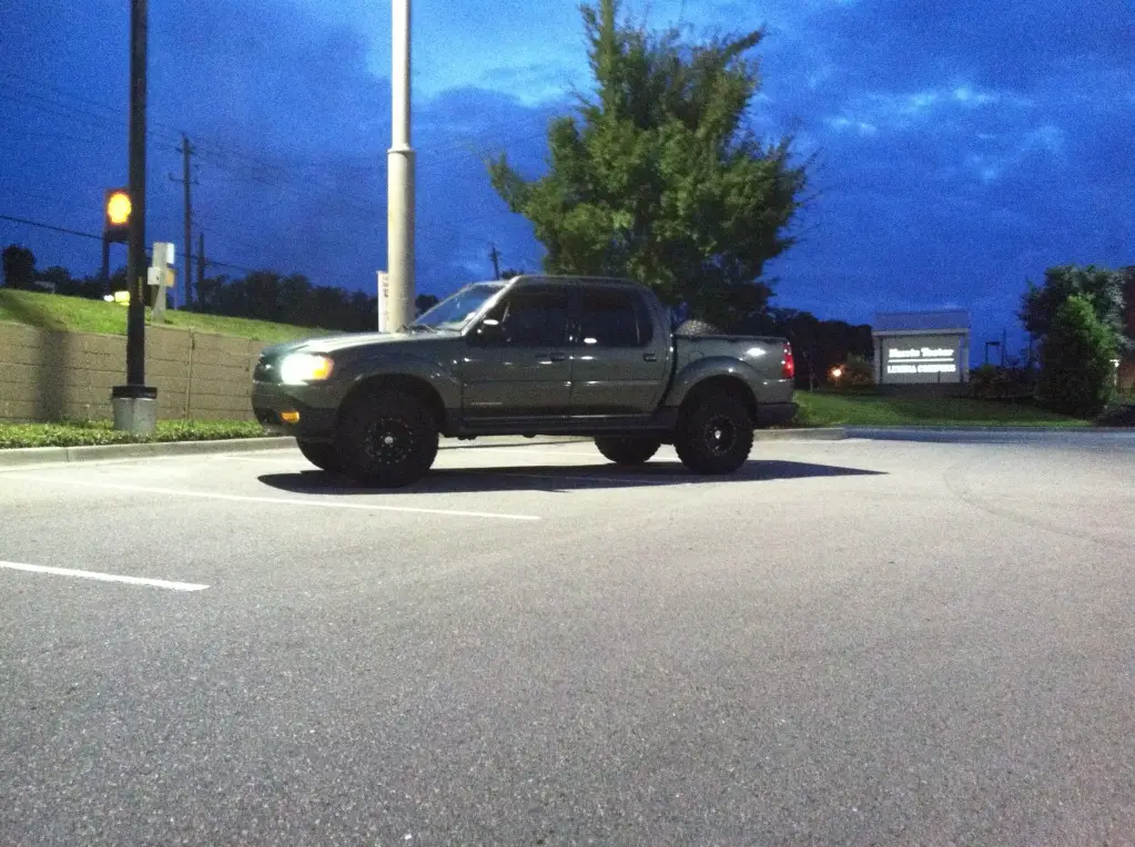

here it is at ride height, its not the greatest picture but ill get some more this week.
rode on the interstate today for about 4 hours and boy i think its a thousand times better than before. it still needs work. like i said before itll need taller springs and some fresh rebuilds in the foa bumps. and im doing spindles to clear the tires. also it sits about an inch lower because i only have a little bit of preload on the springs. Thank you CFS Offroad!

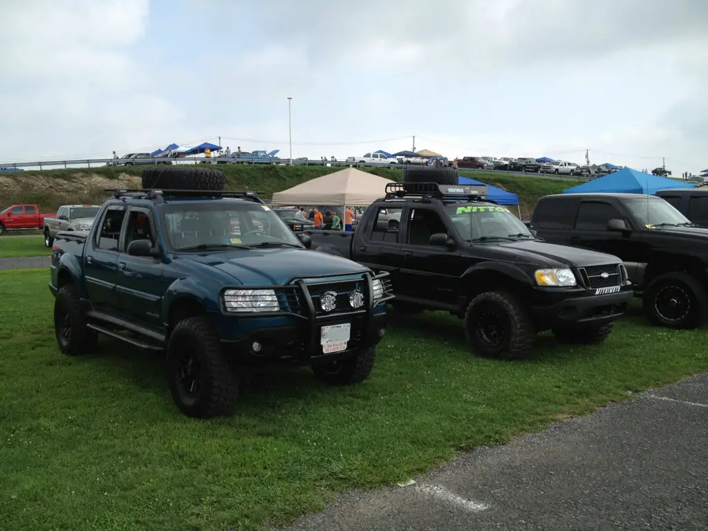

All cleaned up before Truck Nationals and I tried to put a little Luke in the pic lol
Brent and I on the field

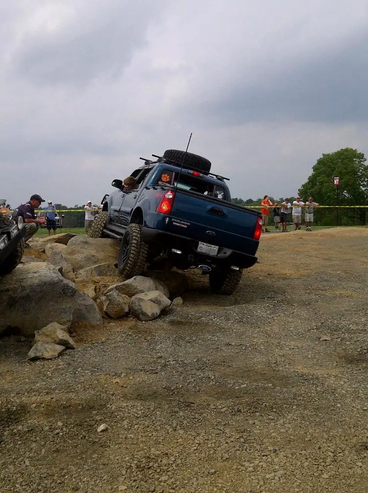

And a little playtime on the rocks that Rausch Creek set up

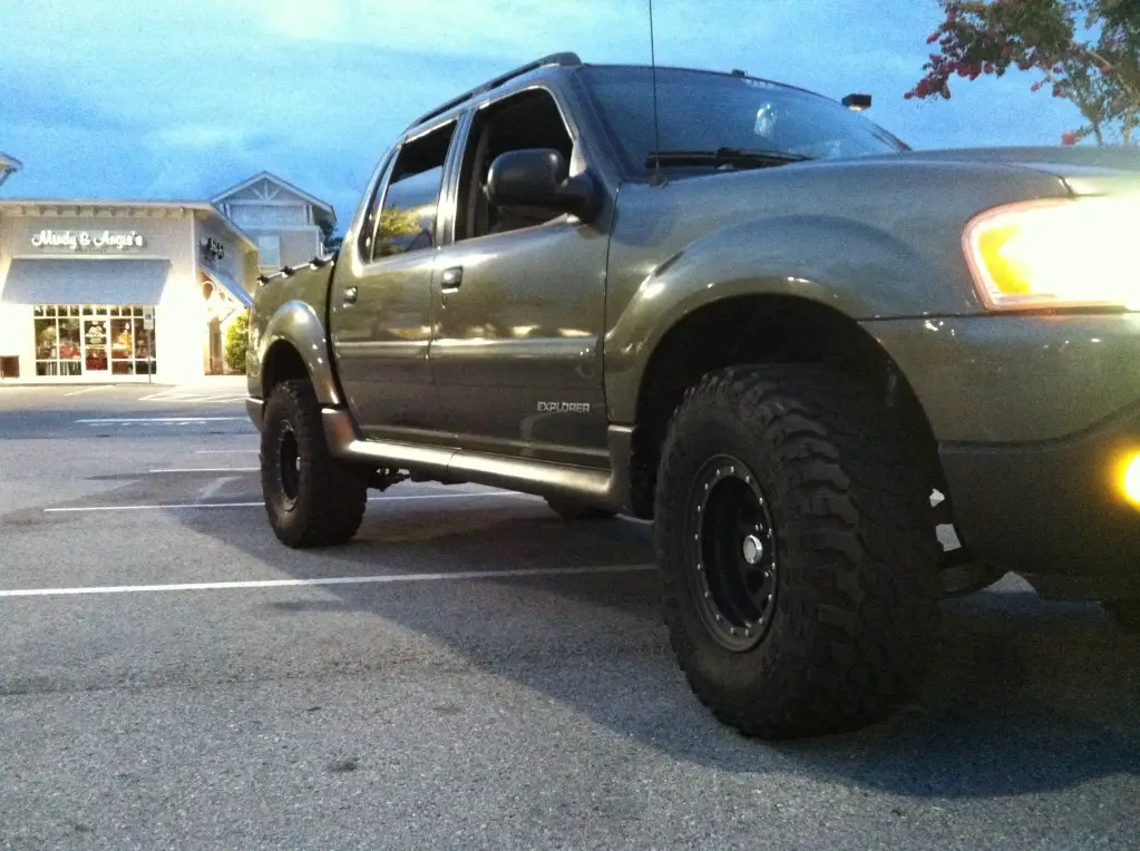

alright guys i managed to get off my lazy butt and go out and take some pictures on vacation..... theyre crappy.... oh well lol
if anyone is in wilmington for the next week i'm here. im at wrightsville beach. lets meet up!
