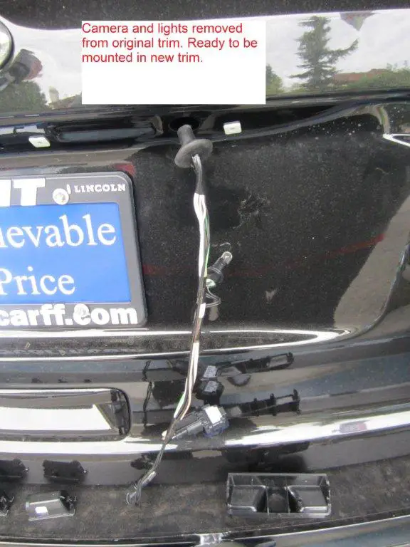

I can get a black trim piece off a same year Police Interceptor Utility but they are for PIU's without cameras. My XLT has a camera.
Is it possible to add my existing camera to a trim piece from a vehicle with no camera? I don't mind if I have to do a little Dremel work to add the camera housing. I tried painting my chrome trim but even with steel wooling the surface and using automotive paint it's peeling so I'd like to replace it with a factory black one. Anyone try this before?

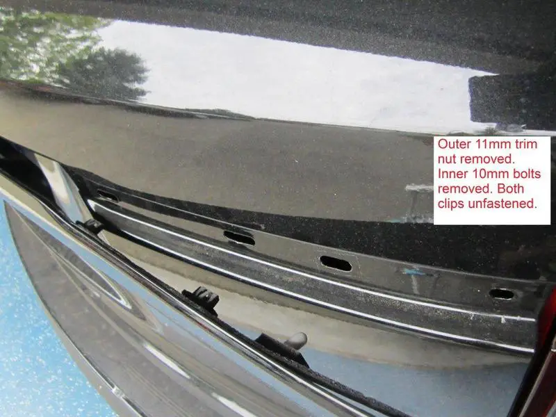

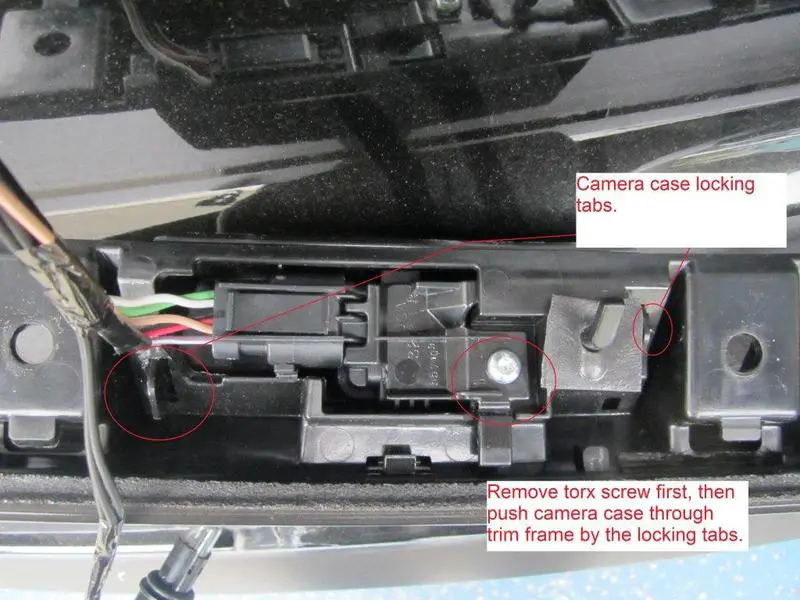

I ended up removing my trim completely. Needed that Torx driver to get the camera out but it was pretty easy. Unplugged the wiring and DONE. One caution, I threw masking tape around the locating pins that are part of the trim piece while it was loose, dangling from the wires, etc. as I dismantled the camera mounting. This prevented them from swinging free and scratching the paint. Once covered in masking tape it was safe.
I power sanded the old paint off and scuffed up the chrome plating to give the new paint more "tooth." I used VHT Epoxy satin black. This is one of the toughest and "stickiest" paints around. Very robust. It was a nice day so after I did an alcohol wipe down I let the trim warm up and gave it several coats. I let it dry in the warm sun thoroughly and remounted it. No problem. It's actually been a few weeks since I did that and the paint is holding up 100% and looks great.
