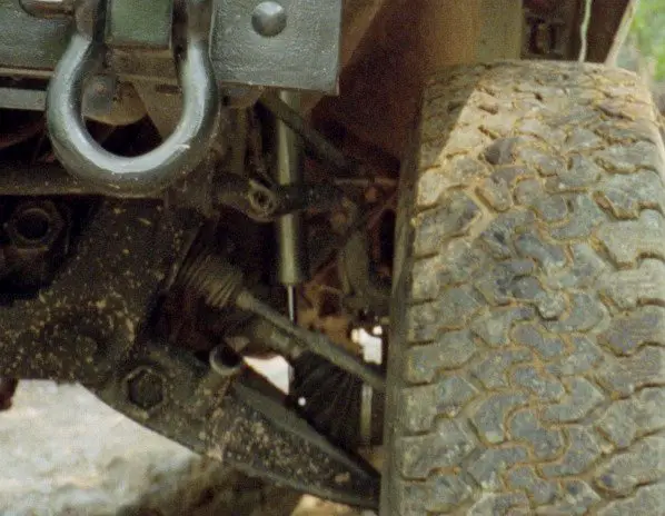

A picture of what i am straping for the futrue referrence and those that wanna see why i need straps
The frist one is the overview the second well its a close up shot of my cv angles, The wierd thing is : It still had room to go lower ?!? only another 1 or 2 tho

Oh and if i go with 16" straps I should be able to use existing holes in the frame and rear of the lower arms and it will limit me above that there...
comments please.

dayum you got that thing MAXXED out!! thats exactly what i was thinkin to with the 16" strap using some existing holes. im prob going to mount mine on the control arm on the side where my lower shock mounts are going to be. (the new hole i have to drill on the side) which hole are you gunna be using on the frame? and 2ply or whatever should be fine, they are rated for 7000lbs, and thats PLENTY!

Just think if i hoop it and add a coil over no torison bars. If i do that i'll drop the front diff 1-2" at least so i can get more travel. Maybe a slipjointed cv shaft ...
At least now you know why i was able to pull the cv's out a little from the axle.
